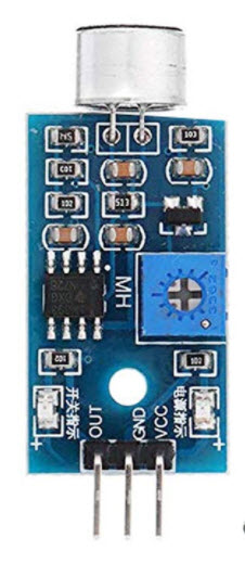

I need to run a small dc motor (4.5v) with a sound detection module
Shown here.
I don't know how to connect up the digital output pin to drive the motor and it appears that this output varies in voltage from around 2.8 to 3.2 volts which makes the motor run too slow at times. I need the motor to be either off, or full on at 4.5 volts. To complicate matters, the output measures full voltage with no sound and then with sound goes low from 2.8 and up. Searching the internet for info on this module only turns up connections to an arduino which I don't want to use. I'd like to use a minimal of discreet components like a transistor etc.
Any help would be greatly appreciated.

Your photos of a sound module and a player have no detailed specifications or link telling what the products are made to do.
I found a cheap sound module like yours at Banggood.
Since it is cheap and is Chinese then it has no details about what it does and how much current is its output.
You also did not say how much current your motor uses. Your motor probably overloads the module.
It seems likely that the output from your sound detection module is a digital bitstream. You're not measuring a voltage, you're seeing your voltmeter's response to a signal that's too fast for it to understand.

I found some more info on those modules here:
It looks to have a preamp and threshold detector, adjustable by the preset. From that article, the output switches low when sound above the set threshold is detected.
The output could replace a button to ground for a small signal control such as the music player module or similar.
To run a motor, I'd suggest using a cheap timer relay module, eg.
The listing for that says it is triggered by connecting the input to ground, exactly what that sound detector output will do.
You can then use the relay contacts to control the motor.

The mike board in the thread isn't a preamp, it's been endlessly discussed in various threads - both modules are incredibly cheap, come from China, and have that countries quality of design and documentation! :D
