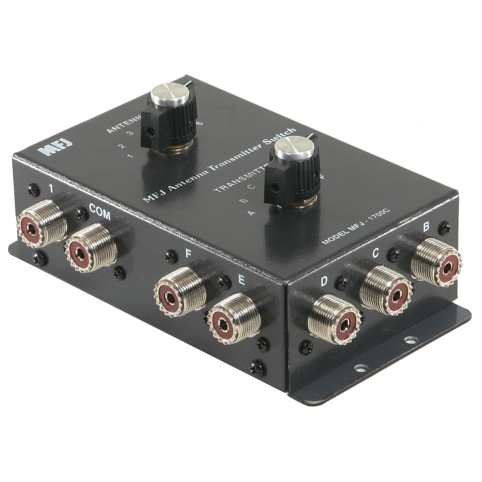

There are commercial multi radio to multi antenna device out there already:
The biggest problem making your own is maintaining a 50 ohm impedance through the switch, and providing isolation between radios. Without enough isolation between radio ports, a radio transmitting might blow the front end of the other radio, even though it is switched out.
You may be able to figure out how to make 50 ohm stripline PCB and use reasonable relays, but isolation is even more important....
