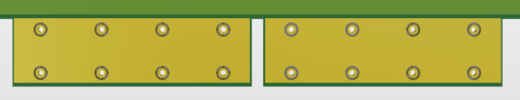

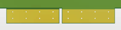

Hello everyone,
I 'm now designing an adapter PCB using Altium Designer. I want to use some vias to reach the figure in picture 1, but now I always get it like in picture 2. I'm new to PCB design and also new to Altium Designer. I don't know why there is always the space around the vias like in picture 2, which is not possible for manufacturing. Does anybody have ideas how to fix this problem? The attached is my PCB design file. Any help would be appreciated.
Best regards and thanks in advance!
Runze

You have to add the vias to the samevl net as the copper areas.
It appears the VIAs are not in the same net as the copper area, so are having isolation rings added.
Check the net and try changing it to the same as the main area?
It's not a program I've ever used, but that is a typical different-net effect.

Hello, I found the answer at Design>Rules>Plane>Polygon Connect Style>PolygonConnect. I set the Connect Style to Direct Connect and I got the results I want. And there maybe some distortion to the via connection to Polygon in some layers after resetting, just redraw the polygon and the problem is gone. Yes, you got that idea. It is indeed something related to Thermal Relief box, but we can reset this box using this method. Hope this maybe useful for someone who has the same question.
