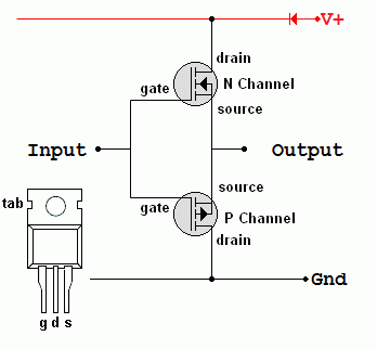

I am working on an RFID reader using HTRC110 with a coil antenna of 18cmx12cm but I could not get the desired range (at least 10cm) for a small tag 10*12mm like this one Hitag S 256 Pigeon Ring. In this document HTRC110 Application note I found out that I can use external power MOSFET-transistor pairs to drive more current to the antenna, but I dont know which mosfet to use or how to use it.

With MOSFETS, look at any smallish logic level (very low threshold) type devices that can handle 500mA to 1A; don't go for large ones as the gate capacitance is very high with power types.
Try a P channel + N channel complementary pair with gates linked as input and sources as output, with drains to power and ground.
The input is TX and the output is Antenna?
TX1 and TX2 are the driver outputs of the HTRC110 IC, and they are designed to provide the power to make the coil resonate, but they can also be used to drive MOSFETS which in turn power the coil.

Thank you for your answers. I made a simple diagram (below) from what I understood from your explanations and I hope you will revise it for me.

You would need a complementary pair of MOSFETs for each TX output.
Something like this for each output; ignore the device pinout and diode:
The input of each buffer circuit connects directly to each TX pin, the other antenna coupling & matching components would then go to the outputs of the buffers instead of the TX pins.
(But it still needs the antenna setting up correctly, to work).
