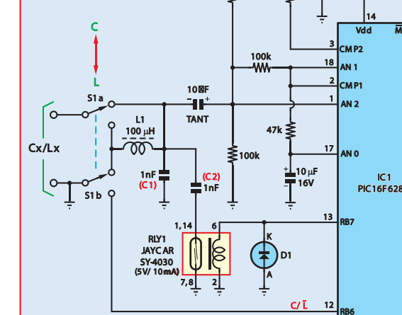

Hi
I need to know the mode of switch depending on pin 12 state?
is when switch on L mode thus pin12 Low & when switch on C mode thus pin12 High ???
In L mode pin 12 is Low. In C mode pin 12 will be High, provided there is an internal pull-up enabled on pin 12. Without the pull-up the pin will be floating, which is a no-no.
thanks ... the problem solved

Hi
i use MCU atmega16 to switch relay (MCU vcc=5volt also relay open with 5volt)
but the problem is the voltage measured from MCU is 3 volt and not enough to switch relay
what the solution ?
Sounds like your relay is drawing more current than the mcu is rated for. You will need a buffer stage between the mcu and the relay.
That' my suggestion.

That goofy thing has a wierd way of operating a relay. It looks like it uses two ports? What ever happened to the diode to absorb the kickback? I suppose the original designer wanted to assure the relay was off at power up?
To the OP: You have to look at your relay, both the voltage and the current required and to what extent the ports can source and/or sink current. The operate voltage has to be within the limits. I don't like the way the relay is driven.
