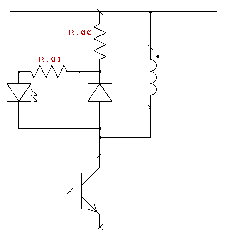

Hey all this would be my first try at creating a schematic in KiCad.
The schematic is a basic 2-channel relay.
The inputs are automotive 12v and gnd. This gets converted to 5v by the K78L05-1000R3.
The Wemos D1 mini has 2 digital pin outs that are 3.3v going to the LTV-356T with a 200 kOhms resistor in between.
From there it goes to a 1k resistor and then to the PMBT3904. Between that and the G5LE-1 relay is a 1N4007F.
In that same area is another 200 kOhms resistor that’s connected to an LED.
The outputs and inputs are the 2pos and 4pos 3.5mm Pitch Terminal Block Connector 300V 8A.
Just want to make sure my values are good and the components I have selected are suitable for my application. Please let me know if I am missing anything or have a value incorrect. Thanks!

The only direct experience I have where slow release could have been a factor was on the control board of a frost-free refrigerator. For some reason the relays were DC and were powered from 230 V 50 Hz mains using a current limiting capacitor and a full bridge rectifier. On one of the relays the NO contacts were welded shut.
Now I don't know whether the slow reduction in the current on that fridge had anything to do with the failure. The fridge would have been built down to a price and the compressor and defrost heater would have been cycled on and off several times a day at least, so the relays would probably been stressed quite hard anyhow.
The peak voltage on the transistor will be increased by a factor of R100/[relay resistance] so you must make sure that the peak voltage is still less than the transistor maximum Vce.
The resistance of the G5LE relay is 39 Ohms. The current at 5 V is 128 mA. When the transistor turns off, that current will flow through R100. If R100 is 220 Ohms, that will give a voltage of 28.2 V across R100. The voltage between the collector and emitter of the transistor is that 28.2 V plus the supply voltage plus the diode voltage, so about 34 V. That is OK for a transistor rated at 40 V or more.
The resistance in the freewheel circuit is 39 + 220 Ohms, which is 6 - 7 times larger than it would be if the diode were directly in parallel with the relay coil, so the current in the coil will reduce about 6 - 7 times faster.
The LED current is limited by both R100 and R101. If the LED voltage is 2 V, R101 is 0 Ohms and R100 is 220 Ohms, the LED current is 13 mA. R101 can be increased to reduce the LED current if required.
The connection with R100 and the LED in parallel with the diode instead of in parallel with the relay coil prevents the reverse voltage spike of 28.2 V being applied to the LED.
In your application it may not matter if you turn off the relay coil slowly. It will still appear instant to someone watching. The curves in the data sheet show that the life of the relay is reduced quite a lot as the load current goes up, and inductive load reduce the life.
Many automotive relays have a resistor built in, in parallel with the coil, and no diode. The transistors that drive the relays have to be rated to 100 V or so, if there is no external diode, but they probably would be anyhow. Having no diode means that the coil polarity doesn't matter.

Final schematic:
1) Removed LTV-356T Opto.
2) Added 10k between Base and Emitter of the PMBT3904.
3) Connected LED to 5v line instead of the collector line on the PMBT3904.
4) Replaced 200R with 220R.
5) Replaced normal fuses for blade fuse holders.
6) Replaced 18v G5LE-1 relay with the correct 5v relay G5LE-1A4 DC5 model.
7) Added a solder pad for the always on (AO) +12v line.

Another way is not to use a standard freewheel diode arrangement. Instead, connect a zener diode across the driver transistor, between the coil driving point and GND. The main advantage is that the "flyback current" of the coil is dumped into GND rather than into Vcc.
The zener voltage must be at least equal to Vcc so it is not conducting all of the time, but it can be greater. For example, if you have a 12 V system and use an 18 V zener, the relay will de-energize much more quickly than with a standard diode, and most of the coil energy will go through the zener to GND.

I decided to do a quick practical measurement of the speed of an automotive relay, with and without a diode.
TLDR:- The time between the NO contact opening and the NC contact closing is about 2.5 times as long with a diode in place.
Here is the circuit that I used:-
The Omron E2K is a capacitive proximity sensor that I used as a device that would switch quickly, and I had one available. The two 3.3 kOhm resistors allowed the oscilloscope to see the different voltages for the NO and NC contacts, because there is quite a lot of switch bounce going on.
The relay was a standard automotive relay, Land Rover part no. DH22-14B192-DA. The 680 Ohm resistor is contained within the relay.
With the diode, this is what happened:-
The NO contact opened after 10 ms and it took 2.7 ms from that contact opening until the NC contact closed.
I've not shown the circuit without the diode, but the only change was removing the diode. This is what happened:-
The NO contact opened after 2.6 ms and it took 0.93 ms from that contact opening until the NC contact closed.
The NC contact bounces for 5 ms when the diode is removed, compared to 2.5 ms when the diode is there.
The voltage waveform with the diode missing show the big hump as the armature separates. Modelling a relay coil as a simple inductor clearly has limitations.
I think that this shows that the speed of the NC relay contacts opening will be quite a bit quicker when the diode isn't fitted.
