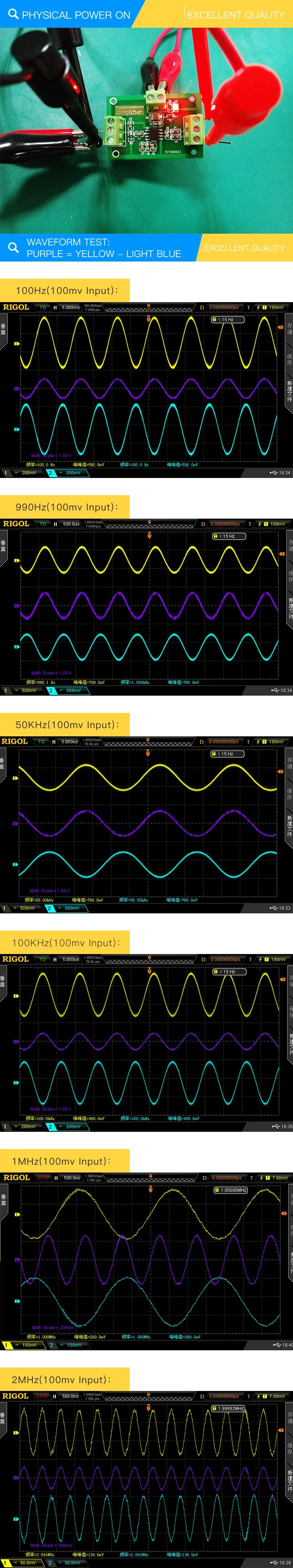

So, good to learn that testing the module with a signal generator is not wrong. I Have added a resistor through a voltage divider in front of the TIA. But probable not enough. I will try tonight getting the signal down to 100mV with different resistors.
Unfortunately I couldn't find a datasheet for my TIA, so I have no idea what the input range is. All I could find was a circuit diagram.
I have an idea now why the diode might not have given me any signal now. Because I didn't connect the reverse Voltage to the TIA module. What I did was following this clue from the sellers page:
In the first picture the reverse voltage is also not connected (left top connector). But of course they wouldn't connect it for the shown test, because they also just used a signal generator and not a photodiode that requires it.
It say both in the listing and in the schematic you posted that it uses an AD8015, which I posted the datasheet for in my previous answer?
However, that module schematic is crazy!
It shows a capacitor (C4) in line with the input pin (pin 2), so you cannot feed the DC bias from a photodiode through it.
And, C3 pretty much shorts out the input at high frequencies!
I'd remove R2 and C3, and link out C4 so the module input connects directly to pin 2 of the IC. It should then hopefully work as the IC datasheet shows.

I added the 100k resistor between the voltage divider and the TIA and got the same results. Then I changed the voltage divider so I get 100mV output like seen in the example screenshots by the seller above.
Now I just get a sort of cleaner Square form back from the TIA
I have also added 5V reverse Voltage to the corresponding pin on the tia, which raises the level, but doesn't change the signal.
Then I reattached the photodiode like in the schematics mentioned by danadak and rjenkinsgb. But as before, all I get here is a neat, clean straight line that doesn't react to anything (I cover and uncover the diode from light).

The IC is ultra fast; the PCB module adds components that restrict both low and high frequencies, as mentioned in my previous post. They need removing / bypassing.
ok will do next. Also will have to further reduce the input signal from the waveform generator as it still saturates the IC. I just didnt have the required resistors at hand today.
