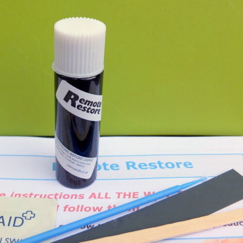

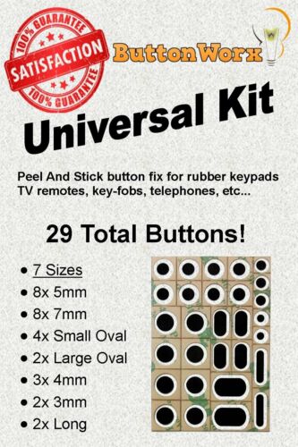

The rubber buttons probably have (or had) a layer of conductive rubber added, to short the contact tracks on the PCB when pressed.
That can just wear away over time, until the contacts stop working.
If that is the problem, you can get various "repair kits" with either conductive rubber pain or stick-on conductive rubber pads, to replace the lost material.
(Similar items are available from Amazon, Aliexpress etc).
