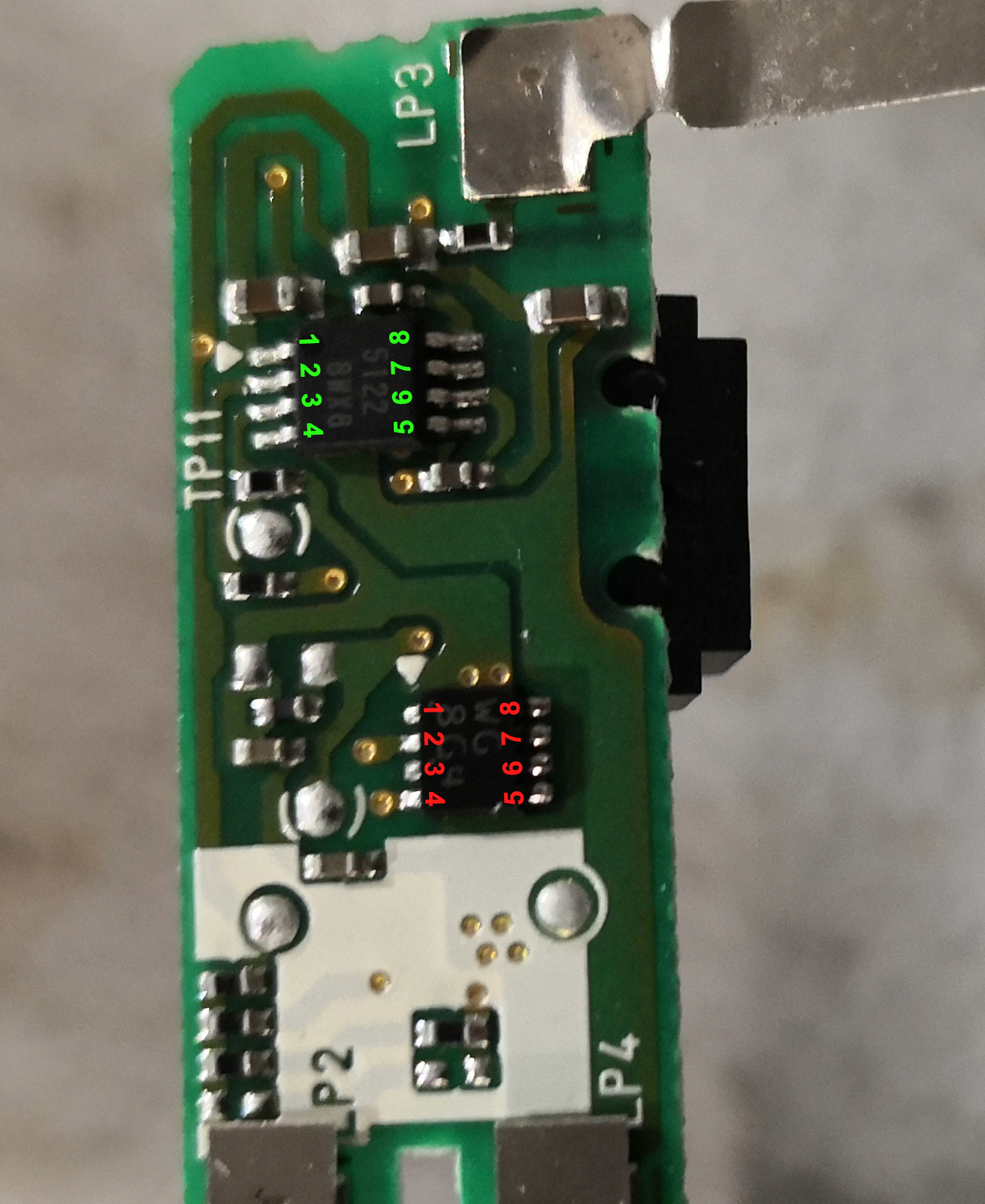

I shorted the + - external connections on the battery for less than half a second. Now the battery is not charging, it is not being recognised in the charger. The camera doesn't see it either. I've opened the battery pack and there are no obvious signs of damage. I am getting reading of DC 7.6v on parts of the pcb (which is correct), but the external terminals are reading 0.151v. I've attached images that I've put some info on. I can do basic multimeter reading where I connect a to b and provide info on the readout.

I have the same battery for a Canon EOS600D. If there's an easy way to open it I can tell you what voltage should be on tp2, I suspect 3.6 - center tap of battery.
It likely has both a power FET to disable the output when the battery is low, and a fuse.
Either could have blown because of the short circuit.
Can you get a better photo of the components on the protection board, so the part numbers are readable?

OK, there are four (or three?) components in a line, that appear to be resistors, at the top left just above "LP2" text.
They may be current sensing resistors, which could be damaged by an overload. Can you measure their resistance?
They look to all be in parallel.
Looking again, I realise you are getting voltage at the test points at the other end of the PCB, so the resistors above may be OK.
Look at the smaller 8 pin device; see which pins it has voltage on?
I suspect that is a dual MOSFET, something like this:
And the other IC is likely one of these, from the number on it:

OK, I should explain my situation. I'm fairly stupid so much anything pass the knee bone connects to the head bone type instructions and I am lost. Much enthusiasm but little fuel as a kid left me without the skills for this stuff and life choices took me away from it. I still find myself pulling stuff apart in the hope that I can get it fixed anything really, cars, electrical appliances, anything really, and while I have some luck sometimes I don't. This is how I came to short the battery.
I've attached another image with the pins numbered. Maybe you could let me know what to do regarding which pins to check with what probe and then I could provide a reading from the multimeter.
Excellent idea! The numbers as you have them could be confusing though, so I've re-done it using the standard IC pin numbers, so they [hopefully] match the device data sheets.
Check between G1 and G4 first, hopefully that will read the same as across the battery terminals (the approx 8V pair)?
If so, can you then measure the voltage from the battery positive contact to every marked pin, eg. labelled G1-G8 and R1-R8 for green and red ICs, that should allow a fair chance at a diagnosis.

I've triple checked these readings to make sure I wasn't getting any incorrect readings. I've included an image of the battery as tested where the negative strap had been disconnected, But I expect this isn't important. I'd have to make a makeshift connection to get to the back of the board if you want me to text the IC's with the negative band connected. No problem, just let me know.
Green
G1. .001
G2. .002
G3. 5.218
G4. 7.61
G5 .001
G6 Varies between 3.4 an 2.9
G7 6.94
G8 7.61

OK; from those readings, it appears the battery controller is in "ready to charge" state., with over-discharge still latched on.
That should be reset by connecting a charger.
The pin G6 voltage reading shows the cells are rather low and that may be holding the output off.
Can you check for continuity between battery positive and one of the external terminals & likewise pin R1 on the FET to another external terminal?
I'm wondering if there is a fuse or blown connection somewhere and one of the external terminals is now disconnected from the rest of the board??

I can unfold the external terminal part and expose the board connections. Lp1 to battery positive is continuous. And Lp5 to Negative terminal is continuous.
When you say another external terminal, please bear with me as I am not that good. Do you mean any of the Lp terminals?
I've included an image of the terminal part folder away from the board. It is still fully connected.

Strange.. It appear it's just low voltage, and may need to be in the charger for an hour or two to recover?

OK. I will put it in the charger. But it is not registering in the charger at all. when I say registering, the charger's red light does not come on when the battery is inserted, whereas the red light was coming on before I shorted it.
Some chargers only allow a very low current if the battery is below a certain voltage threshold, as lithium cells are wrecked by a deep discharge and can overheat if force-charged from that state.
If the cells are still OK, as those appear to be, the low charge should bring the voltage up enough for normal charging to begin, after some time.
If not, then the power FET (IC with the red numbers) may have been damaged after all..
Can you still measure the cell voltage while it is n charge, to see if is increasing at all?

I might be able to measure it while it's in charge but would that be accurate? I've made a 7.5v battery from regular 1.5 cell batteries to kick off the charging and I'll see does that work and post back. In the interim I've managed to break (by mistake) the terminal connector (black) from the board, so I will have to re connect it before I do anything. Damn damn damn. When I've reconnected the terminal part and see if I can get charge from that 7.5v pack into the canon battery I will come back to you, but it will be a couple of days.

OK, I soldered the terminal back on, took a reading across lP1 lP5 and it was .0152
i don't understand
