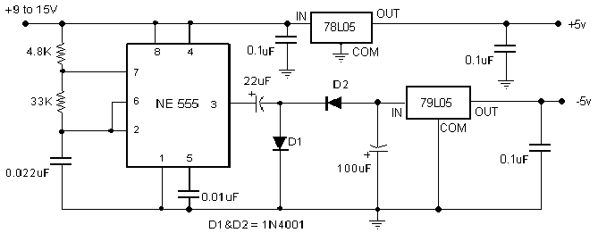

You can build this:
And follow it with a 79L05 to get -5v regulated. Good for under 100ma.

Unfortunately i am not able to isolate the ground points so i cannot simply use a LM78L05 and LM79L05 combination so i am still trying to find a suitable solution.
You don't need to isolate the grounds. That's the whole point of the 555 charge pump circuit; to provide a negative supply with the same ground as the positive supply. I've drawn in the regulators for you:
