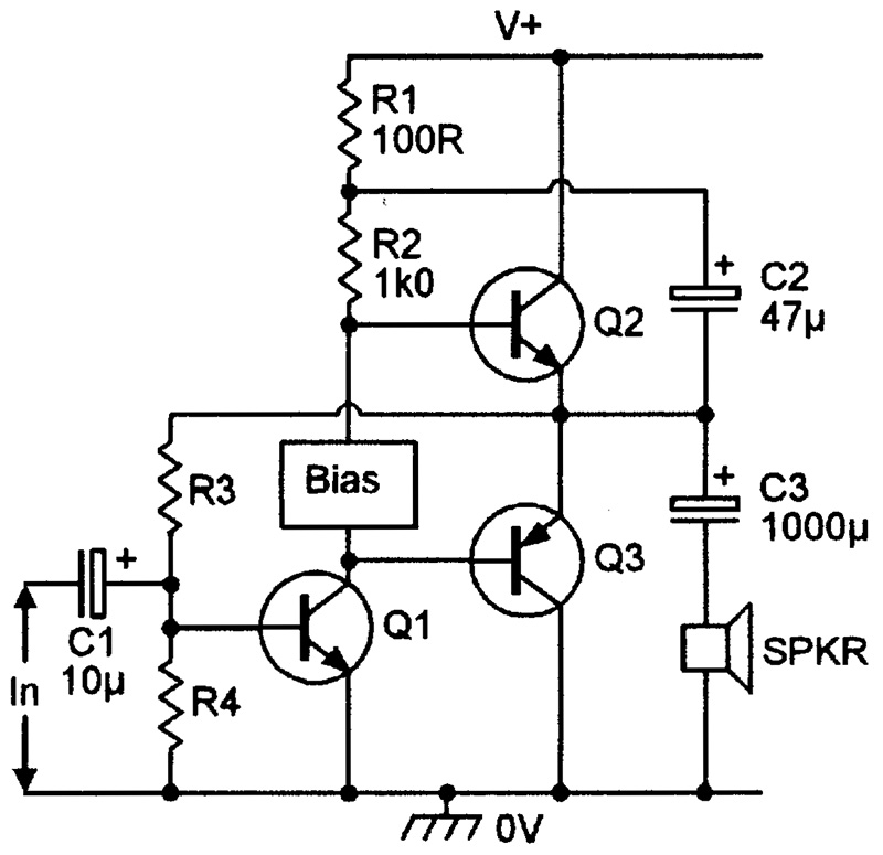

I can't seem to cure this fault though. Please can anyone explain the amp bootstrap?
It's like the audio is there but it's not getting amplified correctly.
The bootstrap cap generally feeds in to near the top of the chain that supplies the output device bases / gates.
It helps keep the current through the drive/bias chain nearer constant, rather than it dropping off when the bases get near the positive rail.
eg. C2 in this example:
Thanks for the lesson. The resistors for the gain were all correct. I couldn't find the fault anywhere... it turned out to be the audio processing on a card and nothing to do with the amp area. Head scratcher and a half
