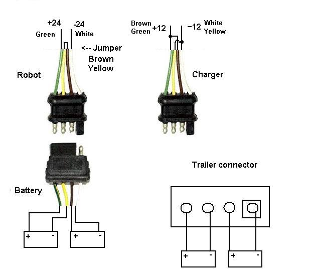

my class is building a robot for capstone we have 2 24v dc motors being powered by 2 12vdc drill batteries wired in series to produce the 24 v.
what i need help with is to build a charging system that uses a 12vdc adapter and when it is plugged in switch the batteries from series to parallel in order for the battery paks to charge.

this is more like what you explained you wanted
Car or truck trailer connectors if you need more amps
no switch
no switchView attachment 107344
Good solution! Would be better if both 12VDC leads (sets) were separaded/isolated into two separate 12VDC - since I think the original poster wanted to charge the Two 12V batteries separately.
Just my 2.5 cents/worth....
