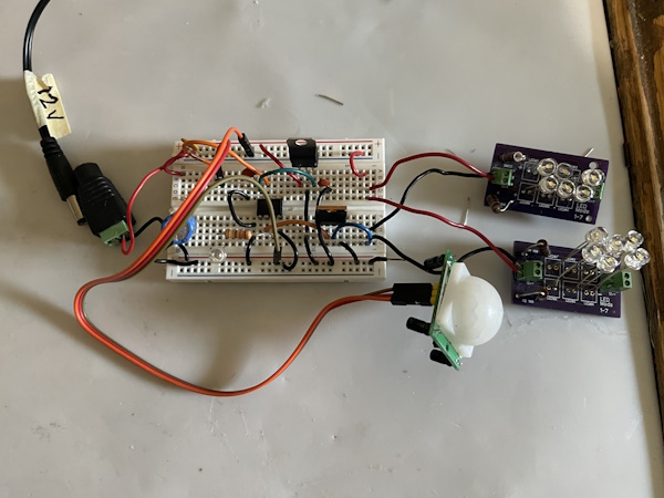

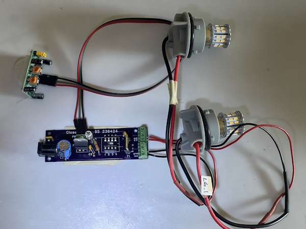

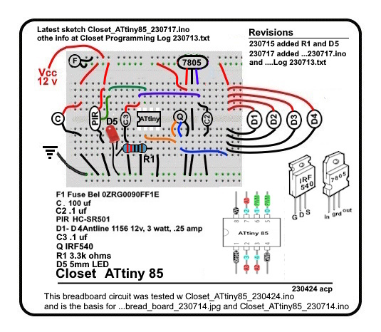

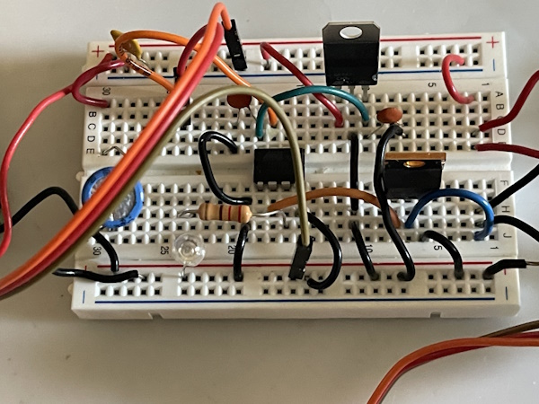

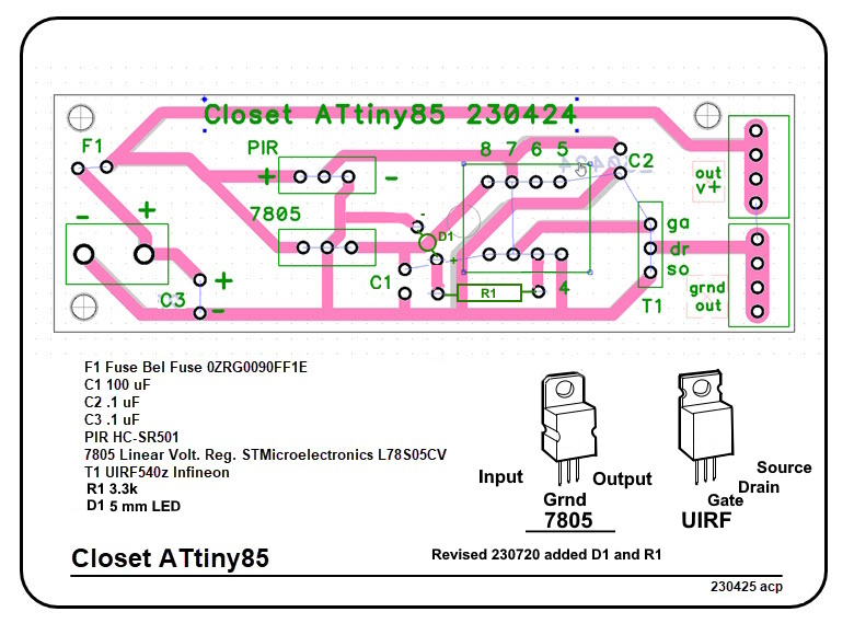

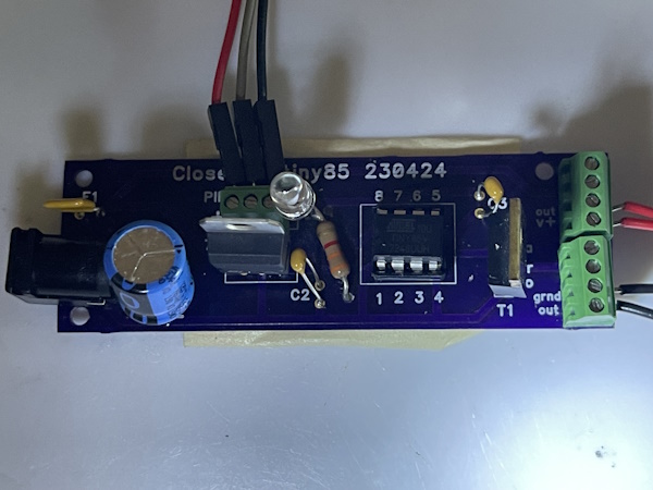

Hello Nigel Goodwin , schmitt trigger and the ETO forum,
Here are some photo and diagrams of the bread board and the PCB.
Careful comparisons of the breadboard circuit and the PCB have been conducted several times but no big differences can be found.
There is a defect in this thread in that I have made the mistake addressing two issues in one thread.
Item 1. The 7805 regulator that overheats in the PCB. I have taken Nigel's recommendation to put caps on the input and output of the 7805. (I think there is one, C3, on the output. Am ordering more PCBs
so will update the PCB design w a cap on the input.)
Also a second PCB has been loaded since the first post and it's 7805
does not heat up. So I've got two circuits that operate at room temperature and one that overheats so I guess it is just a defect in the PCB or other component. The solution is to quit wasting my time on the bad PCB so I can build more closet fixtures.
Here are some photo and diagrams of the bread board and the PCB.View attachment 142179
Solder a 1uF multilayer ceramic capacitor across the input and ground pins of the 7805 on the bottom of the PCB, this will most likely cure your problems.
Instability is highly dependent on layout, your working version 'just happens' to manage to work, the breadboard layout is terrible, and the PCB version not that much better, with no capacitor on the input. Try looking at the 7805 datasheet to see what the manufacturer recommends.
