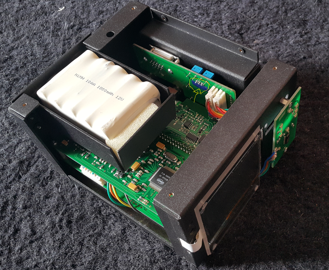

what is the blue in the photo
jazjaz
Hi all,
to be honest I dont know the first thing about electronics
I am trying to find out why my sat finder keeps shutting down at 11.2V using a new 12V niCD battery pack?
I took the case off my unit and it looks like something has dried out? I have circled in yellow the place from a photo of how it should be it (the blue colour)?.
i would really appreciate if someone could tell me what it is please?
Thank you

It looks like some sort of ink or paint - possibly a protective coating or warranty seal of some sort?
It almost looks as if it has writing in it?

Thanks for the reply, I zoomed into the original and it looks like its some type of blue paste which has set? its definitely not a component/part

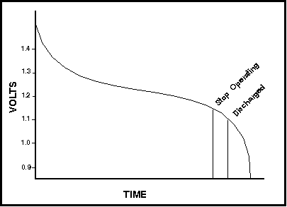

For info, this is a typical voltage vs. time discharge graph for a single NiCD cell at moderate discharge current; your 10 cell pack should be running at 10x the given voltages:

As everybody has said, when a 10-cell NiCad pack reaches 11.2 volts, it's dead. Period.
Either the new pack hasn't been charged fully (can take 24 hours depending on the charge circuit) or it's bad. It may be "new" but if it's sat on the shelf for years, it very well could be bad.

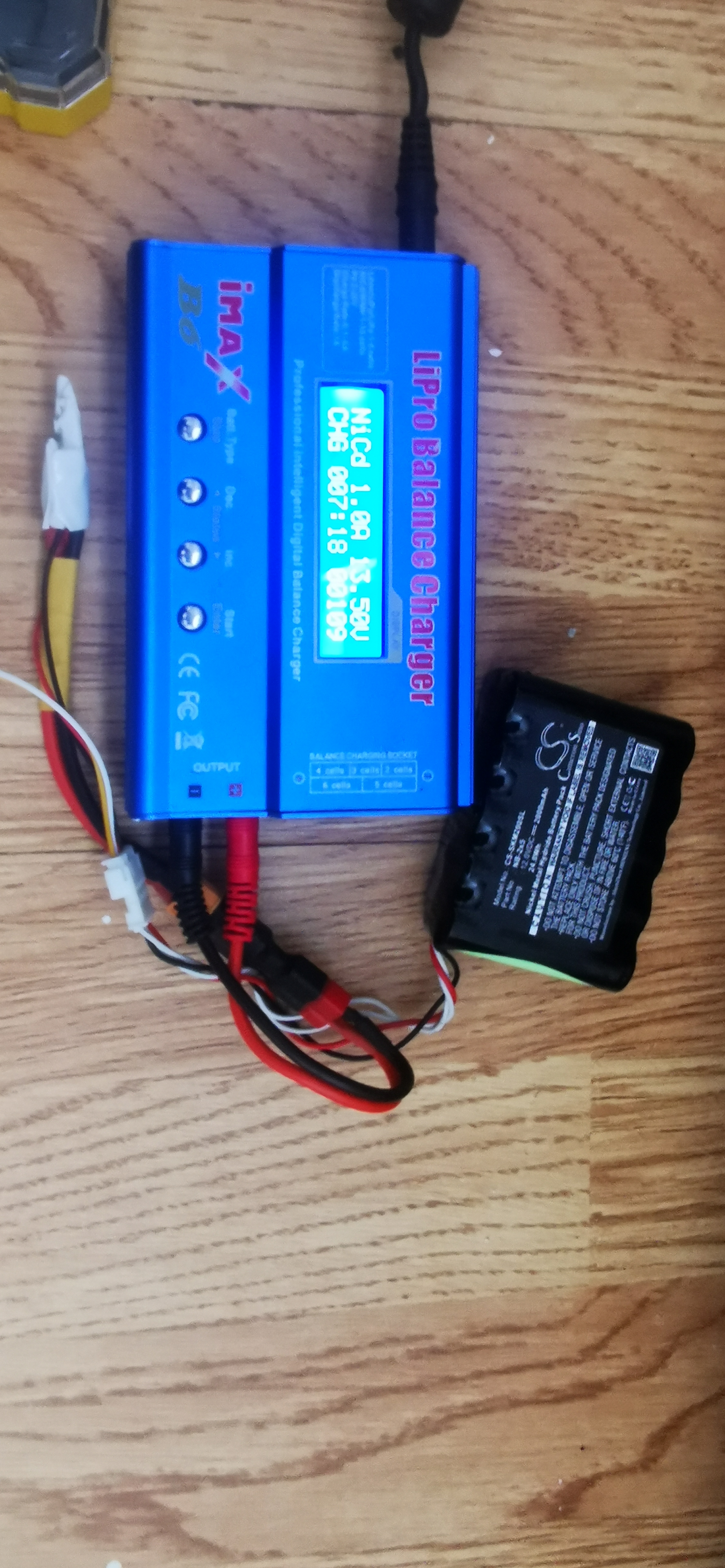

I will buy a 12V charger and leave on charge 24hrs, I cannot understand why the satlook manufacturers use a 4 pin 3cell (3S) balance charge port and JST-HX balance lead on the batteries, I have "ts400 pro duo touch screen and Imax B6" both of which charge all types of batteries but dont want to know these batteries.

Look at the graph posted in post #5 - or the ones I did many years ago at: http://www.lpilsley.co.uk/viewbatt.htm
Your batteries are either flat, or knackered - charge them fully for a start - and see how they perform after that.

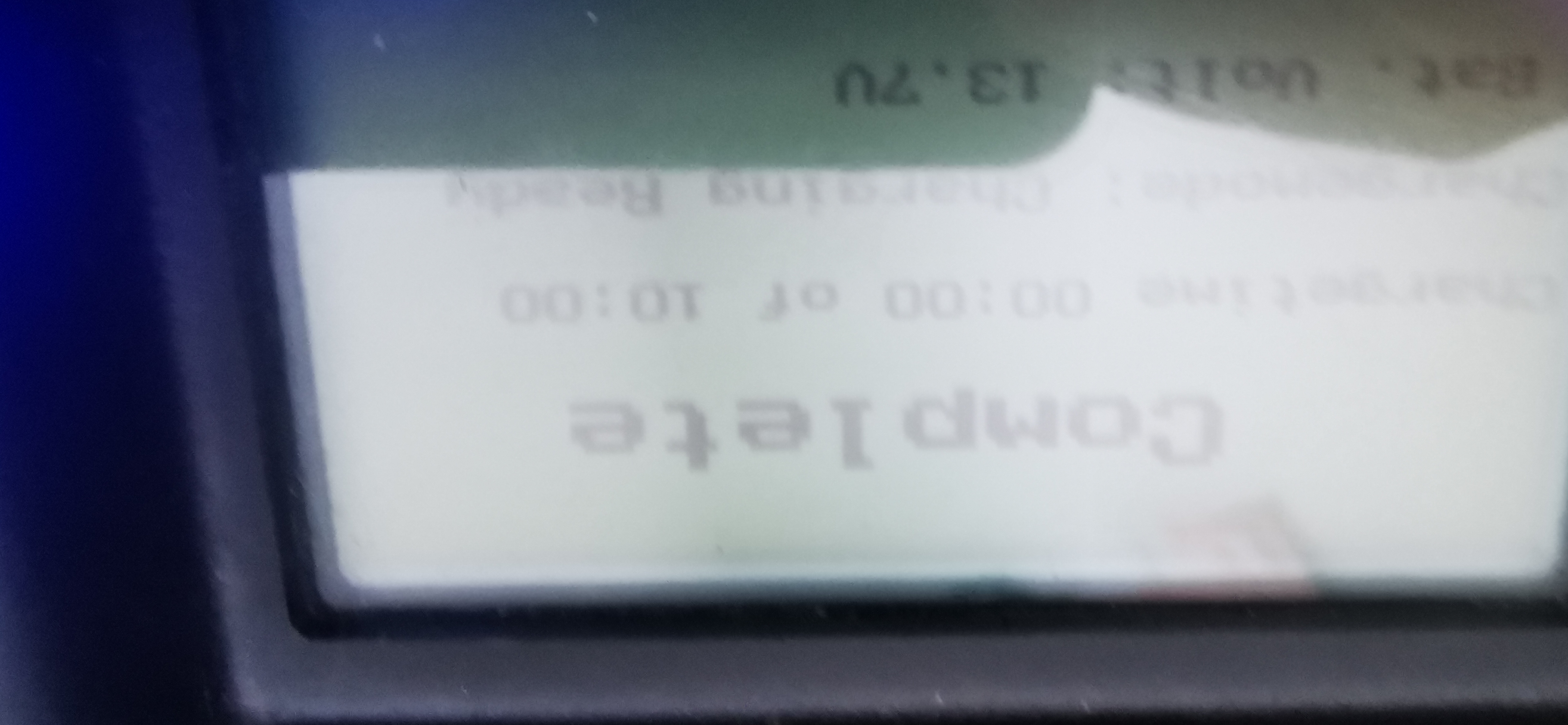

I opened the old pad and discovered the white wires are Not connecting to the unit, I then set up a crude charge and after 3hrs the charge was complete at 13.50v.
I put the put the battery pack back in and it read Complete but would not go into trickle charge as it should?
Attached photos
13.5V "on charge" for a ten cell pack is nowhere near full charge.
It should be somewhere between 14.5 - 15V at full charge.
It sounds like the pack has a dead cell, or that is the charger is set up wrong?

it is a 12volt battery pack and at 13.5volts the pack is hot when fully charged charging at 1.1a
the unit Emitor Satlook Micro+, flashed to G2 (same unit with firmware upgrade) is stated to last roughly 1hr but today I managed to use it for over an hour with power still showing on the battery icon.

As I said above, it sounds like the pack has one dead (shorted) cell. That would explain it being around 1.5V below what it should be.
Stick a multimeter probe through the shrink sleeve under the opposite end of the pack to the connecting wires - there should be a sideways bridge connection between cells 5 & 6 there.
Read the voltage from that to the + and - wires? If all the cells are OK, it should be near equal, with five cells in each half.

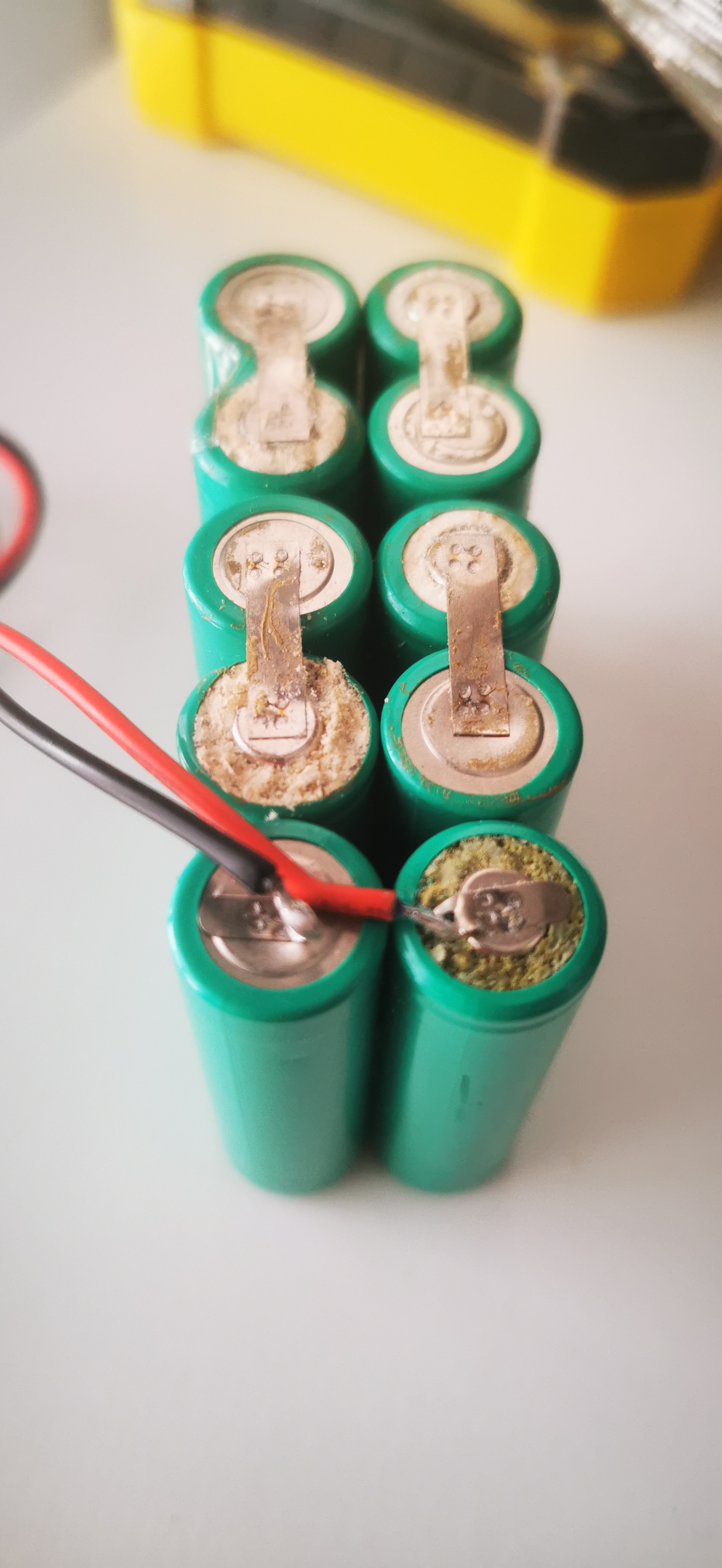

One more thing please?
As the meter was purchased 2nd hand and obviously problems with new battery pack,

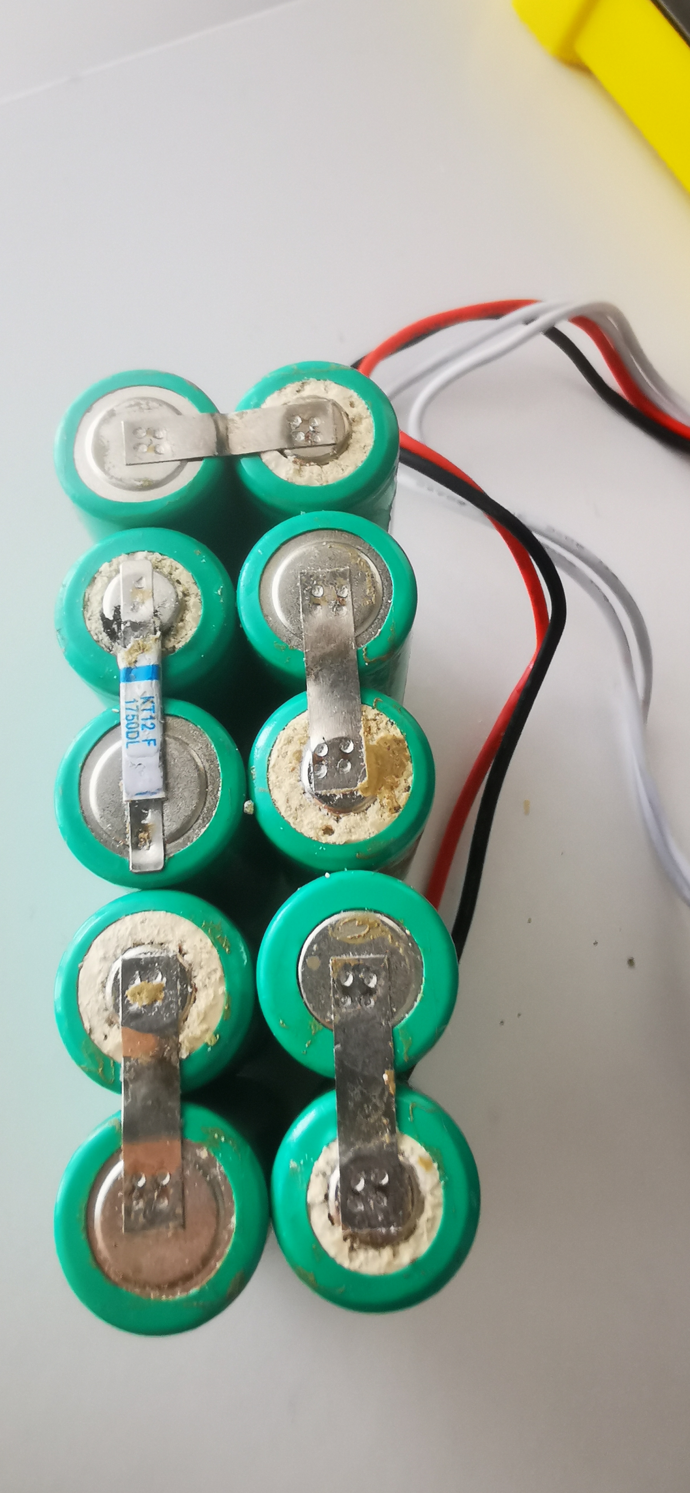

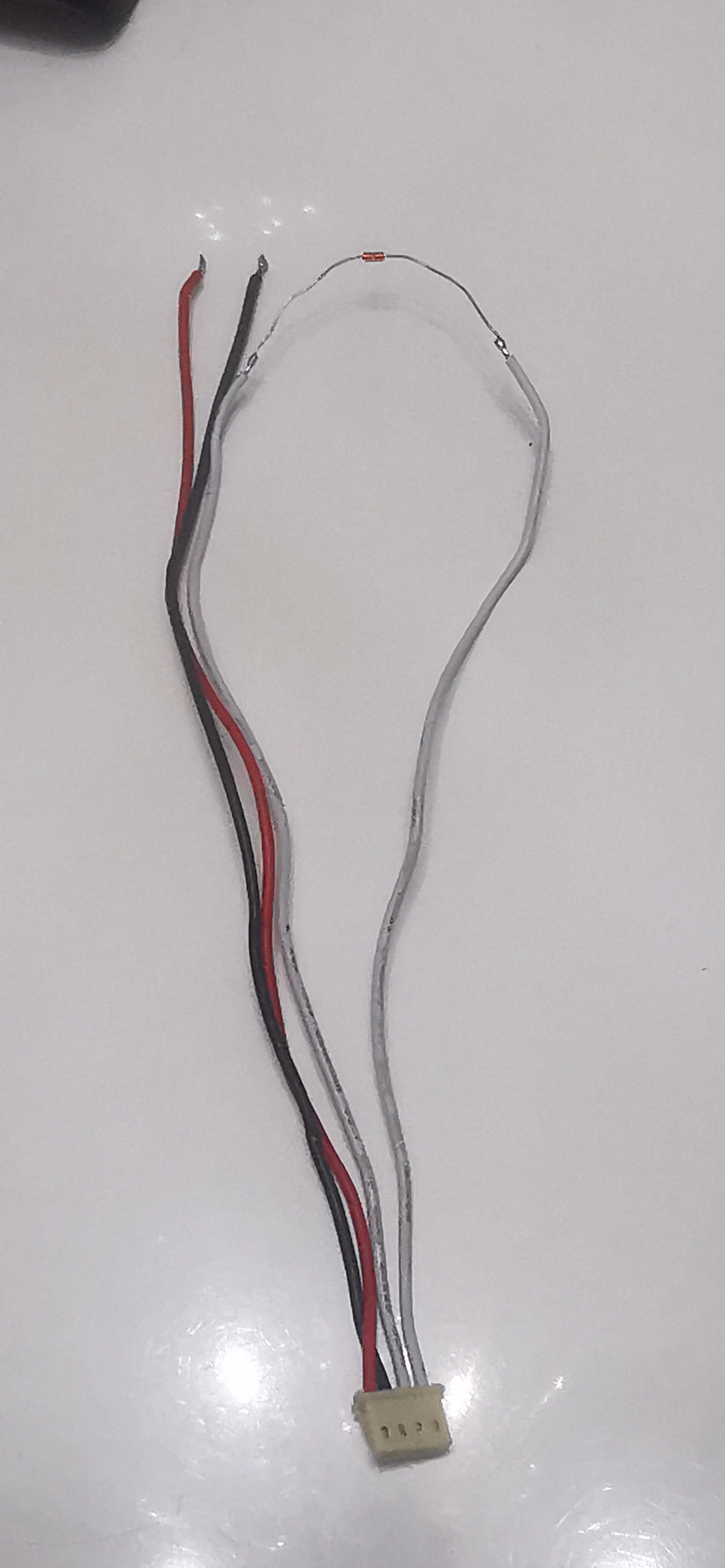

I have decided to attempt to build my own battery pack and follow how the old original pack was set up, please see photos.

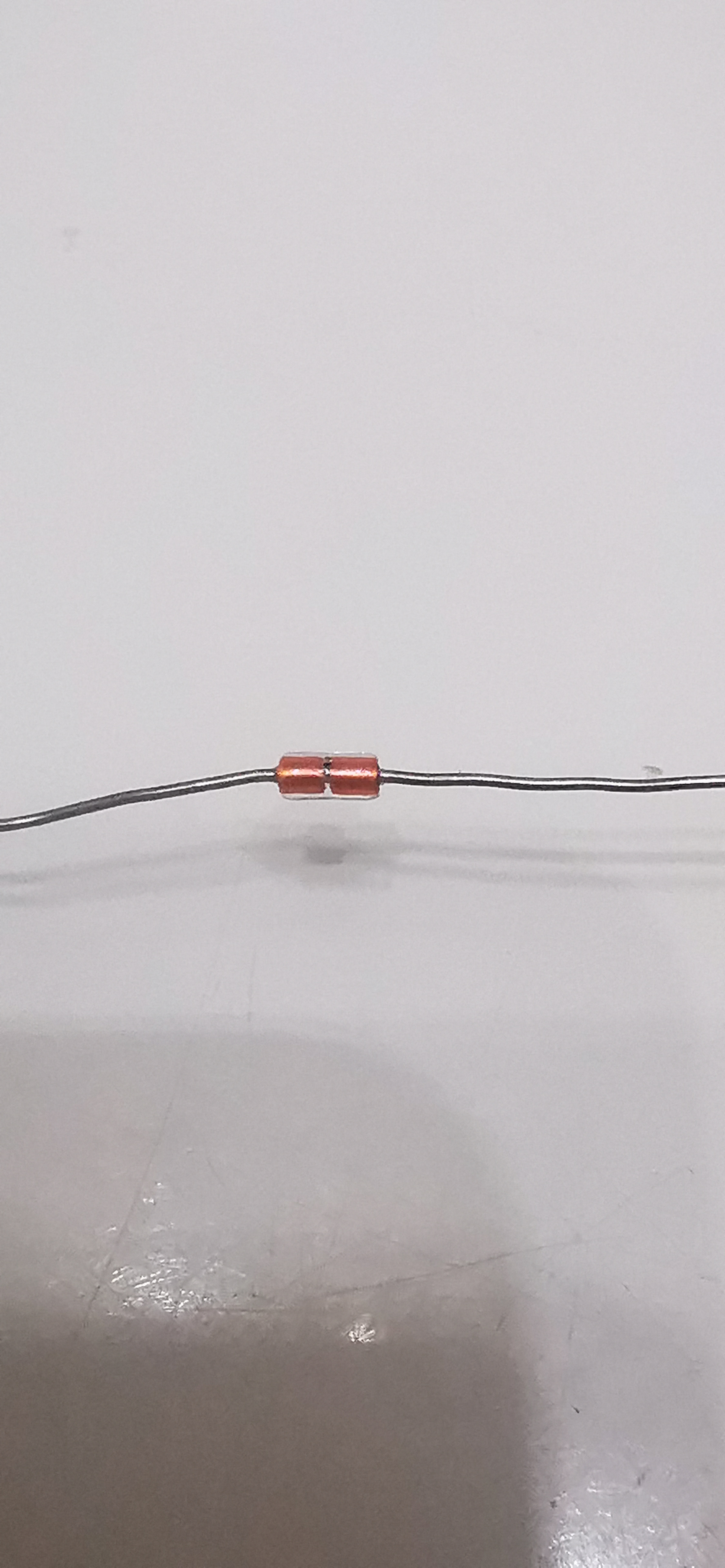

I any info please on the (I think it's a) orange resistor connected between the white wires please?
I have ordered 10x 1.2v 2600 batteries, I will check each battery voltage individually before commencing/begging the build.
I am awaiting all components which could take up to 3 weeks for everything to arrive?
Thank you all again.
My best regards to all.

The orange device is probably a diode, used as a temperature sensor - reuse the existing one (just leave it connected to the white wires as it is) as you've no idea what type of diode it is (and no way to find out). There's also a fuse connected between two of the batteries, you can either carefully remove it and reuse it, or you can buy replacements from RS, Digikey etc.
We make up LOT'S of battery packs at work, so have a spot welder to assemble them, we also keep various values of fuses in stock to avoid using the old ones. We also keep various temperature sensors and connectors (so we can make certain new packs from scratch), but it relies on been able to identify exactly what the temperature sensor actually is.
We also keep multiple sizes of heatshrink, to professionally finish the pack - you can buy pretty well everything from Cellpack Solutions - worth a google.
