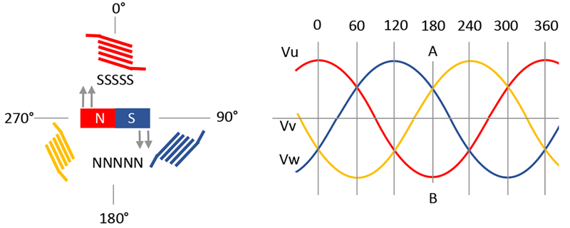

In a wye connected system, it states in my book that if you get the polarity backwards on one of the windings then you reverse the direction of phase rotation. Can someone please give explain.
The book is wrong if it says all you have to do is invert 1 phase to reverse a motor. Doing so changes the vectors and the phase-phase voltage.
A is shown inverted in the sequence ABC which might rotate in reverse but with alot of noise with uneven torque with A in the opposite polarity.
Bottom Fig. shown with correct phase.
If you reverse one winding on a Y connected three phase motor it won't work properly. The armature rotates with the magnetic field and with one phase reversed the magnetic field will not rotate at all evenly. In fact, the motor will probably take far more current than it would normally take.

I think the author is saying that when the three phases were originally connected when building the system that one phase connection was installed backwards
I also found this article , but it doesn't explain why the phase rotation is reversed for wye.

In a 3-phase power system, be it Wye or Delta, there is no such thing as ""getting the polarity backwards on one of the windings". In order to change phase rotation, you always swap any 2 of the leads. This applies to all std 3-phase equipment, be it motor, xfmr, or whatever. In the case of a motor (3-phase induction motor), swapping any 2 line leads reverses shaft rotation. 3-ph reversing starters do just that via two integral contactors, one wired A-B-C, the other wired C-B-A.
Would reversing one wye phase winding reverse the phase rotation for a transformer?
Not properly, the same as with a motor in wye (star) connection and a reversed internal winding.
The voltage distribution would be uneven and the star point no longer at near zero volts.
One of the fundamental characteristics of three phase power is that the sum of the voltages is always zero, and in a motor the winding fields sum to zero (allowing for opposite polarities cancelling each other out.
That results in a smoothly rotating north-south (or multiple N-S pairs) magnetic field between the stator poles.
A reversed winding would make the rotation uneven and the motor inefficient, if it did not just overload.
Take a pencil and paper and draw three equal length vectors, label them R,S,T at 0, 120, 240 degrees respectively, and joined at the center.
What you drew is the classical representation of Wye connected three phase system.
Now, invert R, which essentially means adding 180 degrees.
Now draw R, S, T at 180, 120, 240 degrees.
What did you get?
I will allow you now to calculate the vector value of the R to S and R to T. Does this resemble a balanced three phase voltage?
