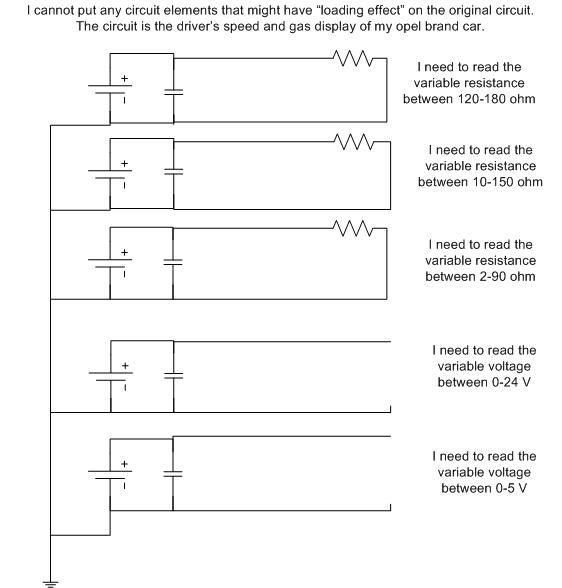

actually I can'T make a voltage division, because I cannot change the original circuit. The circuit should not be modified much, when I add my box to the car, I need to have the analog speed meter still working..
What comes into my mind, is if I can use a shunt resistor in series, and if the analog voltage is guaranteed to be in range of 0-5V on that resistor, it might work. but the main problem is that, the circuit is kinda an analog automobile speed display, which also has a few (12) variable resistances that I need to measure.
I need to read the resistance values between 0 ohm and 330 ohm. and 0 ohm to 180 ohm. the resistance changes , when I speed my car, and it drops when I push the brakes.

The problem is in the attached jpeg picture...
I need to read 3 varying resistance values of the car (as speed of the car increases, the resistance that is "seen" changes from the driver's display side of the circuit.
Also the rpm and gas displays are similar.
Out of gas and over temperature warnings are 24 V and 5 V on/off lights in the analog driver's display...
I need to get them into my pic, and add the digital data into the computer, so that I can create a digital display...
I cannot "load" the observed resistances, that's the reason I wonder is I can use a voltmeter/ammeter type of readout. That I need ADCs, but they are mostly operating in 0-5V analog input ranges, and I have 0-24V analog inputs.
Please help me.. :) thanx anyway...

what I still can't figure out is, if I use a voltage divider for the variable resistor between 2-90 ohm, than how can I divide 2 ohm, without loading the circuit?
if I use 0,05 ohm, is it appropriate, as I don't want the car's speedometer to show wrong results in the driver's analog display... (showing 40 mph while going with 70 mph)
If that's possible, than I will use 0,05 ohm as a shunt resistor and measure the voltage across it for current, and another voltage measurement is needed for the 2-90 ohm varying resistor.

I might need to add that, I only have the two wire ends of the varying resistor.
I can't touch the varying resistor, as the gasoline meter resistance is somewhere else in the car...
the two wires come to the driver's analog display, and I only have the two wire ends...
and I (probably) can't alter the engine of the car.. I prefer only to touch the driver's analog display...
The change in resistor value must be detected in the 'main' unit by a change in the current flowing in the resistor, [usually done by measuring the change in voltage across the resistor], OR the current flow thru a resistor in the main unit.
If you add a resistor in series with 'sensor' resistor you will most likely affect the calibration of the main unit.

I would suugest you do the following tests.
Use a DVM and measure the actual voltage across the individual 'sensor' resistors.
At maximum and minimum limits of the sensor resistors.
Tell us what you measure... OK
