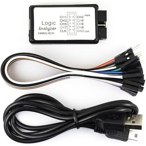

You may or may not know there are real cheap logic analyzer PC solutions with software that can
capture and format the data captured ? Goto ebay and do a search with "logic analyzer chip".
Might be handy to use to verify your code and design.
