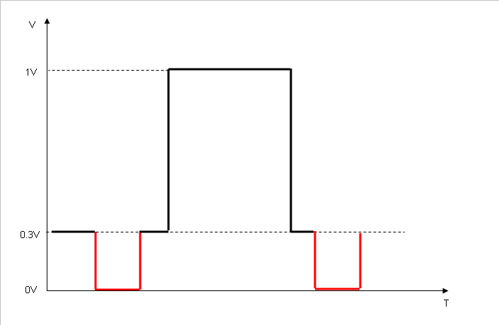

I have the below wave form. Can somebody tell me a very basic circuit to detect the red colour area.High/ low will be fine.
A LM393 comparator could be set to detect this level.:)

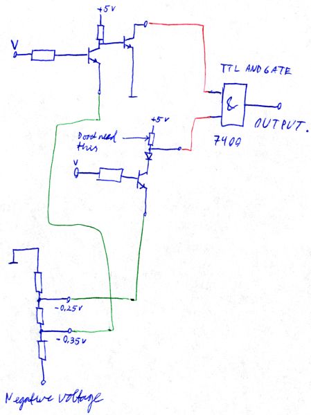

Here's a easy way doing this. However you need negative voltage supply AND you need to calculate resistors in voltage divider. AND you need an and gate (i omitted drawing a bjt-and gate).
From the look of that waveform he needs a sync-seperator, there are some really good IC ones, or a simple single transistor will do the job.
Using a single transistor will also "detect" when voltage is at maximum.

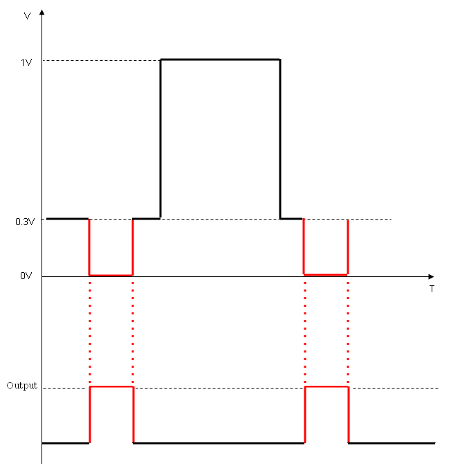

I'll draw a little more to see if I understand this right
