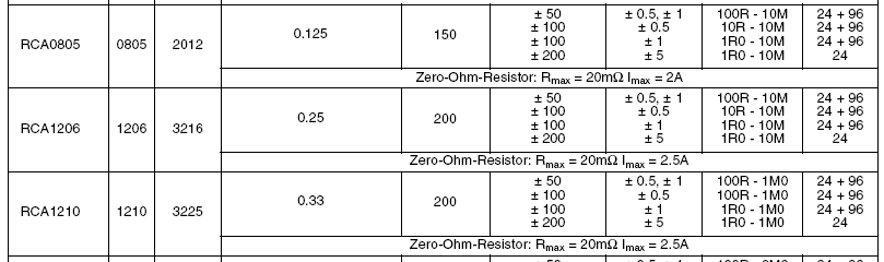

Here is part of a table from Vishay. It looks like the smallest part that meets your requirements is an 0805, which, as you know, is pretty small. As you can see, power dissipation doesn't tell the whole story, if you want to stick to the specs. I suspect you'll find similar specs from other mfrs.
