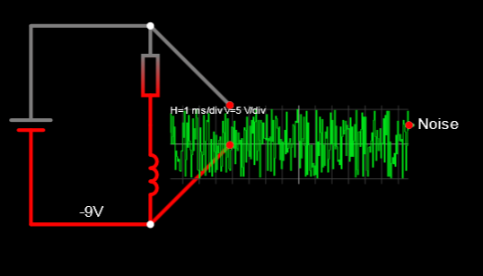

for a great example of carbon noise, put a 9V or a 1.5V battery across any old speaker !! I learned this trick 45 years ago.

Does that mean you'll post a schematic anytime you give the advice to "put a capacitor across the power rails" or something else as straightforward?
Take his description as it is written. It make not make sense to you before you try but it will make sense once you try.
And, I don't recommend leaving it connected for a minute but the effect will be noticeable after the first two seconds.
I don't quite see what you're on about?, if you do that the cone just deflects, and the speaker makes no noise - and it may very well overheat and burn out.
Deflection is one effect but, if you open your ears when you do it, you may learn something about noise. It will be apparent long before the speaker burns out.

Ha ! Just for a few seconds to avoid overheating to hear the hot electrons jumping out of the battery carbon rod. It's not loud, but you can hear it. An old 12" speaker is louder.
I think there was an old Microchip application note to use a carbon resistor and a high-gain op amp to make this noise and use whatever ADC value you capture as a seed for a random number.
