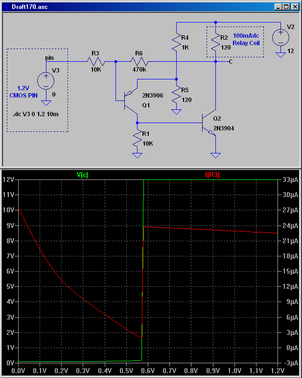

I have a 20 channel programable time that runs on 1.2volt
I am stumped at the moment as i now need to opperate a 12v 5amp relay but dont know how to control the rely from 1.2 volt any help would be great thanks

How much current can the timer output source when its output is high?
How much current can it sink when its output is low?
The signal is high when you want the relay to pull-in?

the volt out put when hi is 1.2v and 0v when low (off)
as I not sure what the current is i will try and work out a way the link is to the timer

The relay in there now has 5A contacts. The timer is made to drive that relay not another.
The most simple way is to get a 240V/20A contact relay with a 220V (or 110v) coil. Have the little relay dirve the big relay.

im trying to do away with the 240 volt side as the programmer is housed seperatly from the mains side thats is why i need a solution to run a 12dc relay or smaller as i have about 900 9vdc reed relays
i had thought about just adding a 12vdc transformer but wanted to keep it all solar if poss

Here is a relay driver that might work for you. Only issue is that the relay is pulled in when the input signal is low, which is likely backwards to what you want.
The X-axis in the plot is the voltage at the CMOS pin. The red trace is the current that the CMOS pin has to sink. The green trace is the voltage at the relay.
I do not know about your timer.
My timer does not use a normal relay. There is no power to hold a relay on all day. There is only power to drive the coil for a very short time. They use a latching relay. It is only driven at the turn on or turn off time and not driven in the on or off state.

thanks for the info but i just wanted to use the trigger to activate a relay seperate from the main board and i think i hae it now so i will build it and see

thanks Mike
if that is the case then i just reverse the timer programe to be on all the time then turn off the timer for the duration i want to travel
excellent think problem sorted
