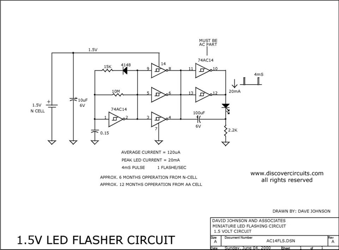

1.5 volts LED flasher for full year ??? is it possible

Both of those circuits blink a tiny red LED once every second or two. If you aren't staring at it, you will miss it.
A white LED needs almost twice the voltage. Even if you doubled the voltage you would not like a torch that gives a weak blink every two seconds.
Circuit - 1.5V LED FLASHER VERSION B - Circuits designed by David A. Johnson, P.E.
Circuit - 1.5V LED FLASHER VERSION A - Circuits designed by David A. Johnson, P.E.
1.5volts LED flasher for full year ? it is possible ?
if it is work, for one full year,
can we made a torch with this circuits ?
to light up one white LED even 6 months ?
help me plzzzz
You have to look at it to be able to know it glows, if at all it works with 74HC series. These types need Vcc min of 2V to work. check the relevant data sheet at ALLDATASHEET.COM - Datasheet search site, Datasheet search site for Electronic Components and Semiconductors and other semiconductors.
However you may Google for single transistor based Joule thief, it works, but may not be for an year.

I might be missing something but I do not understand how this circuit can operate...
The forward voltage drop of most LED's is about 2v +-... your Battery is only 1.5 volts...
It appears to me the LED will not turn on...
If that is correct, you will need two batteries to have a chance.
Hope this helps.
Hello all,
I might be missing something but I do not understand how this circuit can operate......
You are missing the voltage-doubling action of charging the large capacitor to the battery voltage, then switching it in-series with the LED to double the applied voltage to the LED, and letting the capacitor discharge through the LED.
It might be better to use a Joule Thief circuit since it will extract virtually all the energy from a battery.

Bottom Line... power density is power density... (Only so many electrons available in any given battery power source.)
Then apply the math before soldering components. At least you have a rough idea of the outcome...
