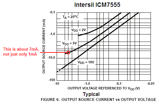

The circuit you have posted will not work because the electrolytic will not charge when the output of the chip is HIGH as the output will be about 1v lower than rail and the diode removes another 0.6v.
The output will be 1v lower than rail due to the electrolytic being a DEAD SHORT and the chip will not deliver a charging current.

This is entirely wrong:
7555 is a Cmos 555 that has an output that goes rail to rail. Therefore the capacitor charges to 2.75V
The 7555 will only source 1mA when the supply is 5v and the output voltage is 1v lower than rail. The capacitor provides a Dead-Short across the output and thus the capacitor will never charge. Secondly, any slight voltage produced by the capacitor will be lost when the output goes low as the output is about 0.4v above 0v rail.
No.
Intersil's datasheet shows a sourcing current typically about 7mA.

The sourcing current with a 2V supply is shown as typically 1mA. It is probably 0.8mA with a 1.5V supply. The capacitor needs to charge from 0.3V to 1.25V in 167ms. It cannot do it so the capacitor will charge to only about 0.6V.
The capacitor never discharges to zero volts. It discharges to about 0.3V when the LED stops conducting.
This is incorrect. You are assuming the voltage on the capacitor is 1v or more. But the electro never charges.
From the graph you provide it is clear that the current at 2v Vdd is only about 1 mA. The other 7555 chips state 1mA for 5v not 7mA so the current capability at 1.5v will be even less than 1mA.

Which manufacturer of a 7555 has an output high current of only 1mA?
Intersil, Harris, Philips and Maxim are all the same with about 5mA to 8mA. National and Texas Instruments do not show typical current graphs.
That is correct.
The capacitor charges with a little less than 1mA for a duration that is twice as long as its discharge a little into the LED.
It is a horrible weak circuit and the 7555 oscillator might need to make many cycles for the capacitor to become charged enough to dimly light the LED.
It probably won't work if the battery voltage is less than 1.4V.
