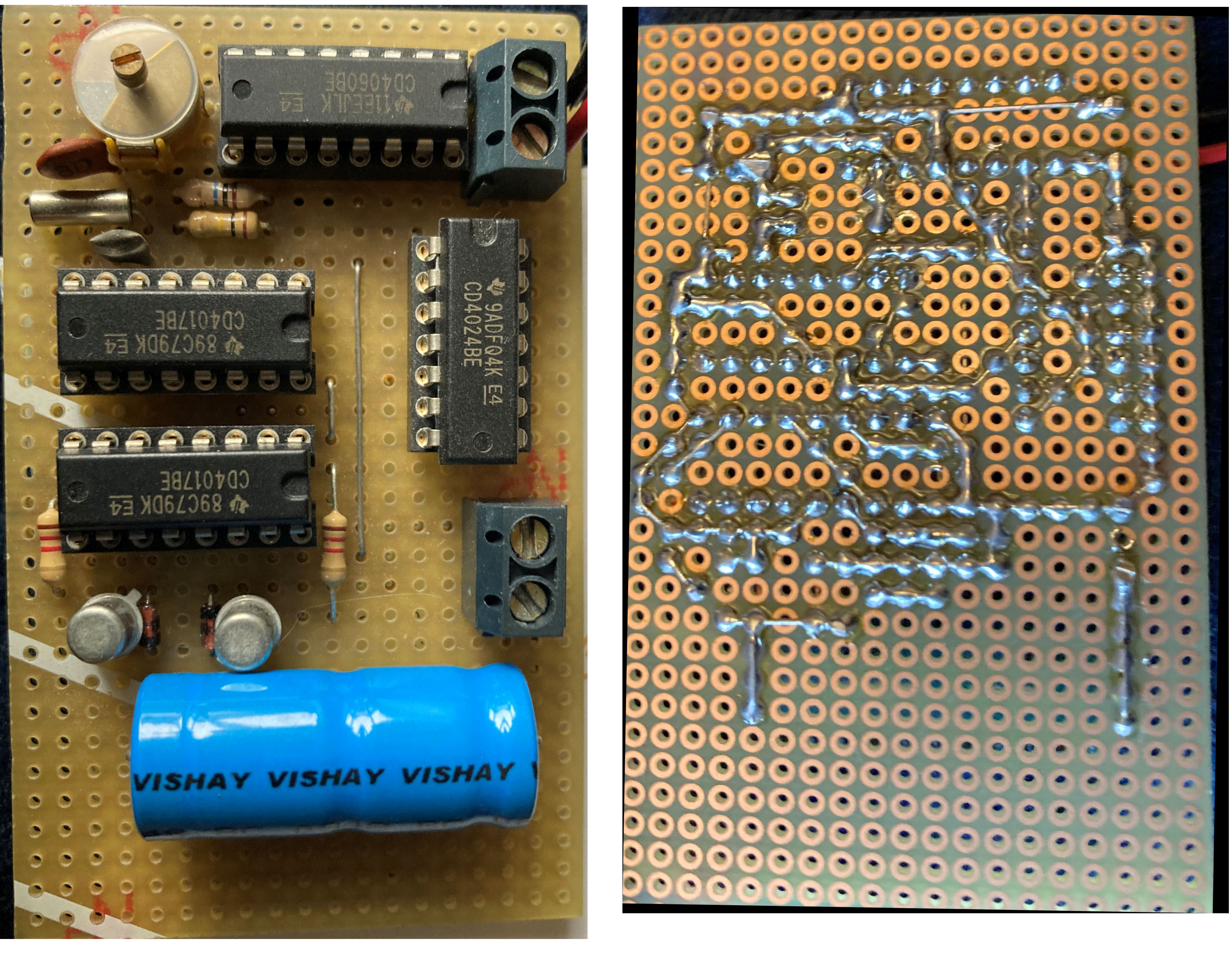

Hello all.
Please see the attached photo of a circuit I’d like to copy. I don’t have the actual board a friend of mine sent me the photo.
It’s a circuit to produce 1 second alternating pulse using the following IC’s-
CD4017B x2, CD4060B x1 and a CD4024B.
Can anyone point me to a circuit diagram for this, maybe there is something online, if there is I’m unable to find it.
I think this circuit is used so it can run on 3v so low power. It’s for pulsing a low voltage Brillie slave clock and needs to be a small footprint so it can go in to the back of the clock and run on batteries.
I look forward to hearing from you.
Regards
Mark

Can you get a photograph of the back? It should be possible to work out the circuit from that.
Some things can be guessed. There's a crystal oscillator circuit with trimmer capacitor in the top left. That is connected to the inverter input and output on the CD4060. The crystal is a 32768 Hz watch crystal, so the lowest output frequency of the CD4060 will be 2 Hz.
After that, more information is needed. The CD4024 is a 7 stage counter, so it probably divides the 2 Hz frequency further but it might be connected to something else. The wire in the middle of the board may connect the clock input on the CD4024 to an output from on of the CD4017s.
The CD4017s are decade counters which turn on one of their 10 outputs, so those could be used for producing short pulses.
There are two transistors, probably to drive the output, but I don't know why there are two. The capacitor is large than I would expect.

If it makes it any easier to trace, here are the two photo's side by side with the bottom mirrored.

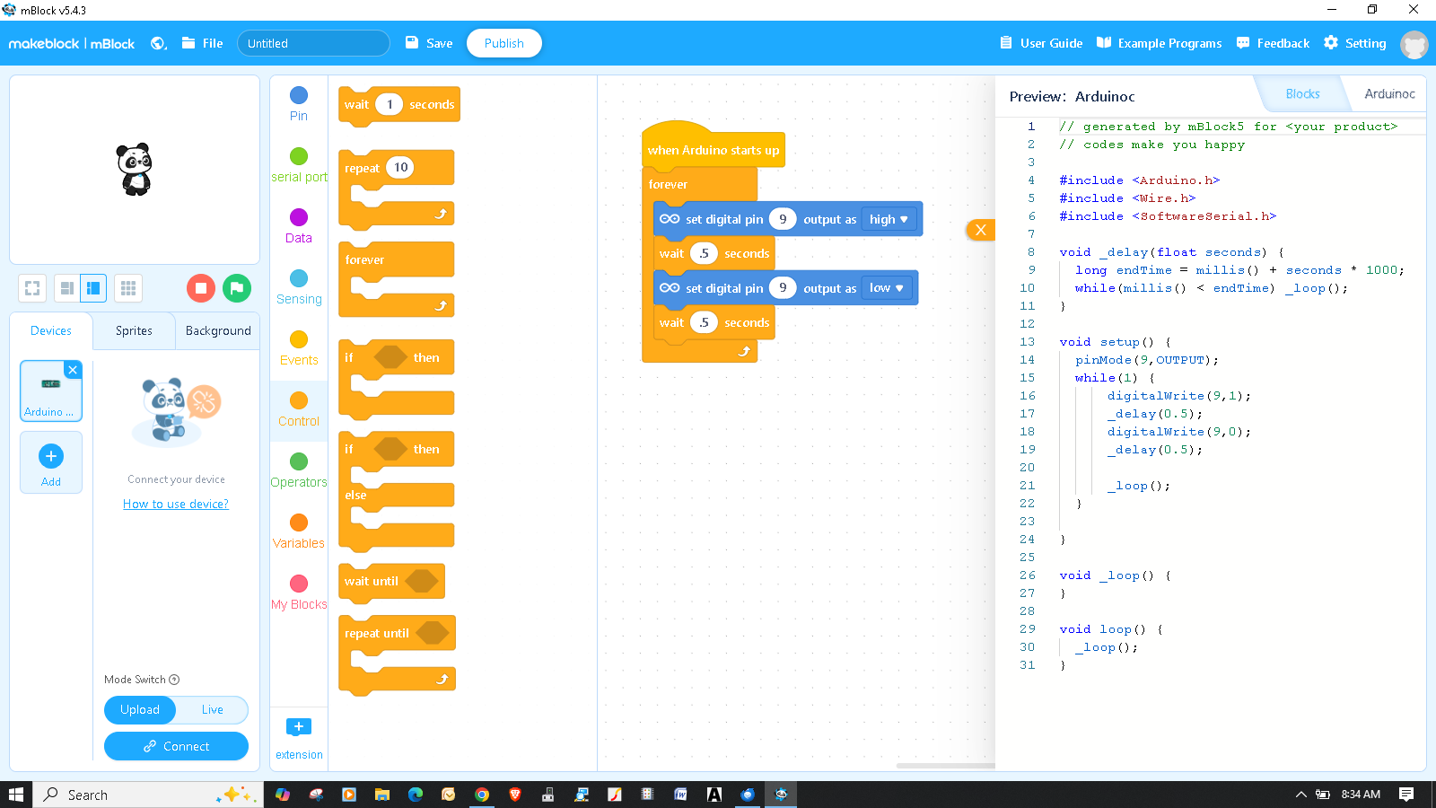

User drags and drops blocks out of second window, into third window, configures, like pin to use for clk, and mBlock gens code shown in right hand window. Third window generates the 1 Hz signal, simple,
thats all it took to create program.
An example of a complex timer / pulse generator design, eg. the utility and ease of programing in
block language. https://www.electro-tech-online.com/articles/pulse-sequence-generator-smart-timer.938/
mBlock takes user configured block programing and generates Arduino code user programs into ATTINY85 or Nano board, using Arduino IDE programmer facility. mBlock is free, as is Arduino IDE.
Simplest use a Nano board as its has regulator and xtal on it, easily interfaces to Arduino IDE programmer
from mBlock. Pic of ATTINY85, and shown in foreground Nano board. Use one or the other.

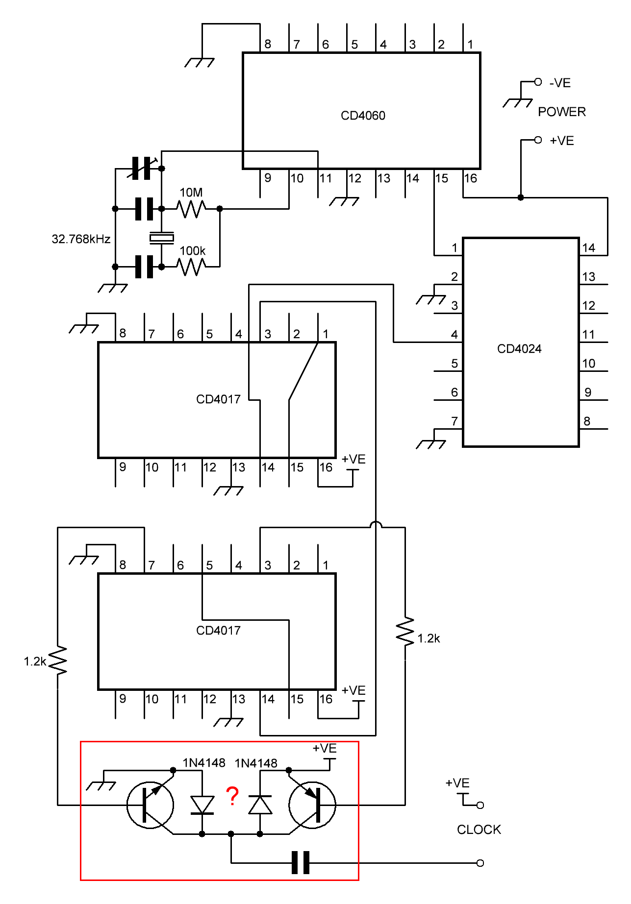

I have a sneaking suspicion this unit gives 1 pulse per 30 seconds - hopefully somebody more adept at working with these chips can confirm (or otherwise) my calculations:
The output of the 4060 (pin 15 , Q10) is 32768Hz ÷ 1024 = 32Hz
4024 output Q6 is ÷ 32 = 1Hz
First 4017 is count of 5 and the second 4017 is count of 6 = 5 x 6 = 30seconds.

This is a very quick mud map of the connections (no guarantee it is 100% correct).
The area in the red box is my guess only until we can find out what the transistors are ie we need the part numbers if possible. The values on the three capacitors would help too (I 'think' the trimmer is a 5-60pF one).
I believe the two transistors are 2222A. I have another photo from the side.
