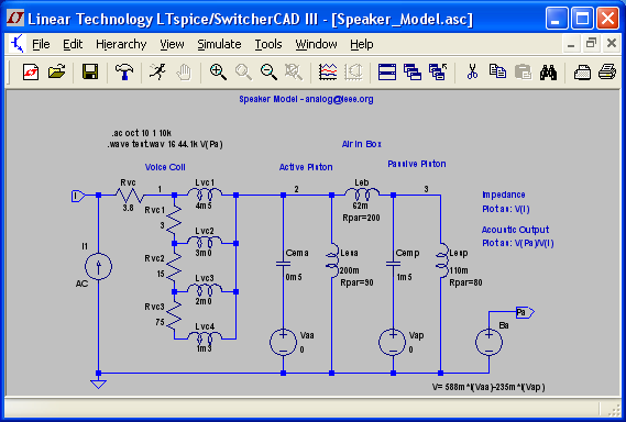

I'm trying to come up with an approximate inductance value to use for a 1 watt 8ohm coil resistance small cone speaker, basically the kind you yank out of cheap radios. I don't have any way of measuring the inductance though, can anyone give me a ballpark figure to use?
Edit: The only refrence to a measured static inductance I've found so far is 560uH
Was trying for a quick and dirty way of getting a better simulation of a speaker aside from an resistor. Never mind though I found a decent spice model that simulates the physical properties of a speaker that's not too bad.
you can't just treat a speaker as an inductor.
a basic rep would be a resistor, if you are starting to want a more detailed model you have to include variable inductance and such... not worth the hassle unless a pro

A resistor is probably as helpful as anything else?, unless you can find an exact spice model for the speaker and cabinet you're using - but an inductor would be no use at all.

I want to feed simulated amplifier output into a simulated speaker to see what kind of results I can expect. It's just a learning exercise for understanding more complex circuits in spice than just a few basic bits glued together real fast. I'm not used to dealing with complex electromechanical systems and I'm learning on my own. After viewing the schematic I understand it a little bit more, there's a few increasing resistor values right off the bat fed into a parallel array of inductors to give a variable inductance for the voice coil. A couple parasitic capacitors that simulate the actual physical feedback from the cone mass.
I found a schematic for LTspice on the Yahoo Groups forum for ltspice
It's attached if anyone wants to see it.
