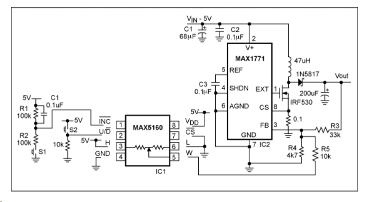

I got a AD5220 digital poti and data sheet says, I only need so switch a push button to change the resistance. Off course also need to select up / down and pull CS low to enable. And get a pull up resistor happening (which is not in the manual, but you need it). But as soon as I pull the CLK input low, it just goes all the way, not just 1 step. I then tried all sorts of debouncing circuits, no joy. Nothing to see on the oscilloscope either, CLK goes from 5 to 0 V without any other noise, so no bounce there. Then hooked up a square wave generator, set to 1 HZ, first pulse and resistance went from 50% to 0.

A mechanical relay is bad news - it will bounce - a LOT.
So in order to do that you would need to provide debouncing - I would suggest figure 3 from the digikey link in post #10.
Either use a schmitt trigger IC (I originally used a CD40106), or use a PIC set to use schmitt inputs (I now use a PIC16F18857), and suitably programmed. Value wise, I use two 22K resistors, and 1uF capacitors (no diode) for my push buttons (which only need to be slow), and two 22K resistors and a 0.01uF capacitor for the relay input (which needs to be MUCH faster, with a 0.01uF it exceeds 1KHz).

post 22 won't work, its 2.5 V then when the switch is closed, will not pull the CLK low enough. It actually goes to 0 Ohm and 9 kOhm at random. Each time I close the switch it goes to the opposite end
As I've said all along, it's a useless 'supposed' debouncer - and won't work at all if the chip doesn't have a schmitt trigger input.
As I've already mentioned multiple times, use figure 3 from the digikey link in post #10 - but again, while it's an actual working debouncer, it still relies on a schmitt input on the chip.
