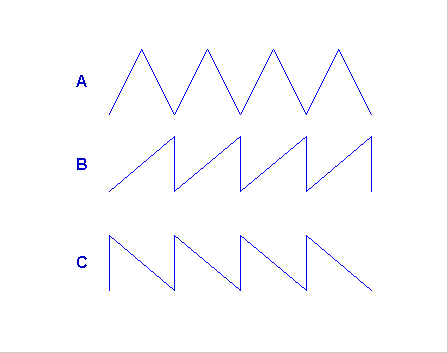

Do you need A, B, or C? How many volts peak-to-peak?

A will be great..........
should be 100Mhz or more but DV offset the output should be 17V - 20V
I would say only A is a sawtooth. B and C are ramps. But I wouldn't be contentious about it.
j.
Well, John, then I guess I have to get contentious. :D
According to this site, waveform A is a triangle wave, and the other two are sawtooths (sawteeth?). I gotta say they all look like triangles to me - maybe A shoulda been called an isosceles triangle wave. I can see why the other two are called sawtooth waves.
