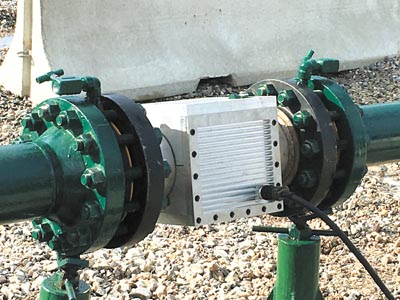

The prime mover is pressurized air (150 psi - 190 psi). The generator is a 240 v 60hz 10 amp motor (wanco AB20L) The load below is a test load 120v 500 watt heater.
The real load will be a bank of 12 volt batteries wired to be 24 volt. I am struggling to understand why the frequency/rpm remains the exact same even though the prime mover is increasing.

Happy to share pictures. If there is something specific I can call Wanco and get that information. They are very helpful. Currently the second unit purchased will have the AB30T on it. The customer like the idea of AC due to the long line run from gernator.
OK, so it's not a "Motor" as you originally said.
It is a purpose built, internally regulated, synchronous alternator.
And totally unsuitable for your purposes.
Those are designed to run from such as a governed engine, so the shaft speed is near constant at the required RPM. Under those conditions, the output voltage would be regulated and not vary significantly with changes in load.
So, 40 posts before he actually gives us any information - seems typical for these kinds of posts!. If he'd done that in post #1 it would have saved wasting everyone's time!.
2 pictures worth 40 posts. Nigel - lets not get crazy here. I have been providing information since posts #1. Any information that was asked for was provided.
I did say it was a generator on my very first post. Admittedly I assumed motor vs generator didn't matter.
Rjenkinsgb - I thought these are all things we already knew. I am looking to solve the issue by either (a) replacing the generator with something more applicable or (b) putting a device in line to convert the power to something usable.
In regards to option B. Is there a reason something like this wouldn't work? The BALMAR Digital Duo Charge 12V/24V Regulator
This type of thing is being done, but not by someone that has no clue.
That's a slave charge unit, from one battery that is being charged, to another. You don't have one charging system yet..
The vehicle alternator is the only type of device that I know will work over a varying speed range such as your turbine unit has.
It's certainly the cheapest and simplest, as it has the battery charge control system built in.
(And I think it's a safe bet that they are far cheaper than the big synchronous generators you have been trying!)
Other devices could work, but you then end up with the same rectification - voltage conversion - charge regulation etc, stages that add to cost and complexity.
