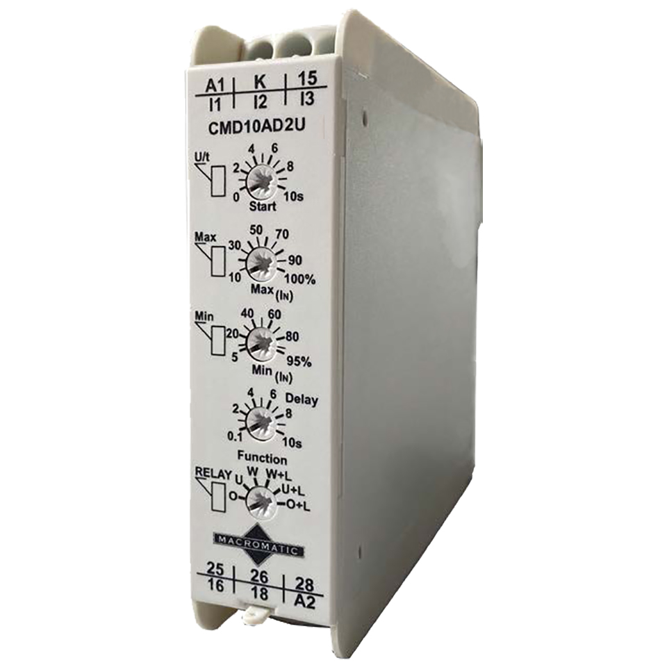

Diver300, any chance something like this could work?
Looks like it's an adjustable Current Sensing relay with either Transistor OR SPDT contact output...
Maybe I could trigger a timer relay to break contact of the 24ac Open/Close supply current for 3 minutes (to make sure it goes around the long Close command)
Hmmm... thoughts?
The problem with those is that you need to allow for inrush current as the motor starts, and you don't want to allow that long when the motor stops. However, give it a try.
As you are interested in current profiles over time, you really need an oscilloscope to measure that (with a shunt resistor as oscilloscopes can only measure voltage)
My suggestion is:- https://www.picotech.com/oscilloscope/2000/picoscope-2000-overview

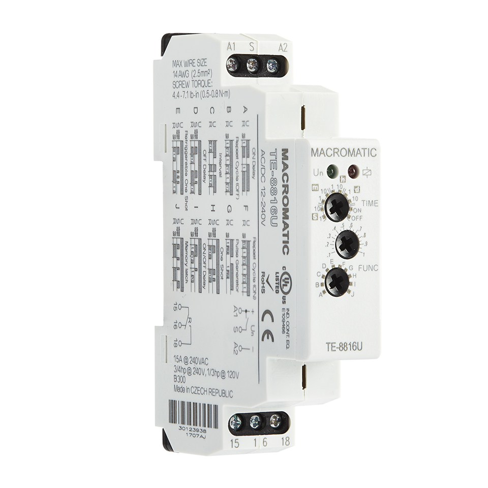

Additionally, I ordered the following relays:
The relay about has a variable start delay to handle Inrush current variants, responds in 100mS and should be able to be tuned to around 65mA...
I also ordered:
My thinking is I can connect the current monitoring relay to trip the Time Relay which should be able to be configured to trip for 3 minutes.
I'm hoping the outputs of this Time Relay can "disconnect" power to the Damper Actuator.
Does this seem like it could work?!
Thanks again,
The relays should work. There are various settings which will be needed, and the circuit will be fairly complicated but that can all be tested.
