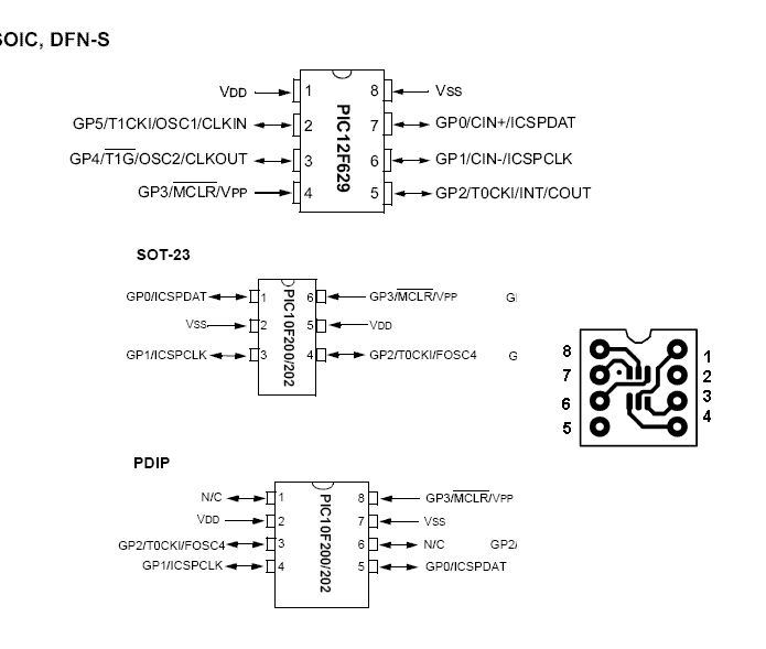

Assuming you mean a DIP package, compare the pinout for the 10F, to the pinout of the 12F in the attached image.
You'll need some way of making the 10F pins match the layout of the 12F.

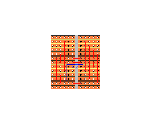

You could try using breadboard and short jumper wires inserted in a 8-DIP socket, then inserted in the ZIF on your programmer (assuming your programmer supports 10F devices) or if you have some stripboard, a 8-DIP socket and some header pins, you could knock up an adaptor.

I have made a stripboard adapter, but I can't find the lead for my camera. I'll do a quick mockup in mspaint and post back shortly......

OK, the view is from the top side, with the copper tracks on the bottom.
The grey section is a track-break. (the board I used already had a track-break. If using standard stripboard, you only need to create 8 breaks...4 between the socket and 4 between the header pins ....you can omit the 3 red horizontal wire links)
The blue section is a 8-DIP socket. Pin 1 is located top-left.
The red bits are wire links.
The black dots at the top are the header pins, soldered to point downwards from the copper side and fit into the ZIF in the normal location for a 12F device. Pin 1 is located top-left.
HTH.
