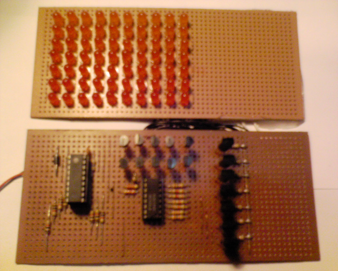

I built a 10x7 led signboard using PIC16f84a.just to get some experience in making moving signs.It consist of count down,scaning from left & right,hold on display,elevator method,adding letters......etc.
Unfortunately I coudn't find any led matrix so I used normal 5mm led's.no mo memory space in the pic to add more patterns only 2 lines left in program memory.
see the attachment for a small video.

So why use a prehistoric PIC?, simply changing it for it's 'modern' replacement the 16F628 doubles your program memory.

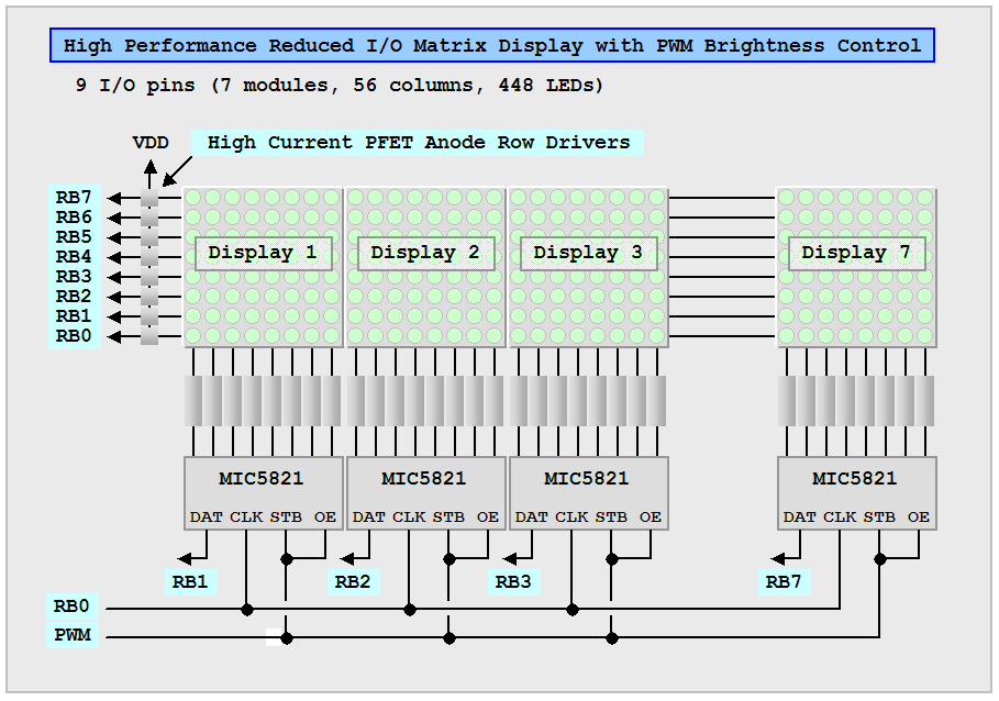

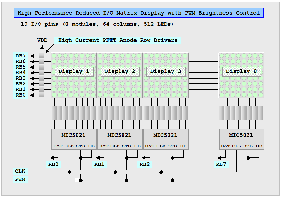

This design with 9 pin interface will drive one to seven 8x8 matrices to full brightness. It uses the PWM signal from the PIC for brightness control and to multiplex the 8 pin PORTB "row driver" bus with the '5821 column driver "CLK" and "DAT" lines to allow loading the shift registers on up to seven '5821 column driver ICs in parallel in about 24 cycles (4.8 usecs).
I can provide simple interrupt driver examples in another post, if you're interested.
Happy Holidays. Mike

Hi again Tim,

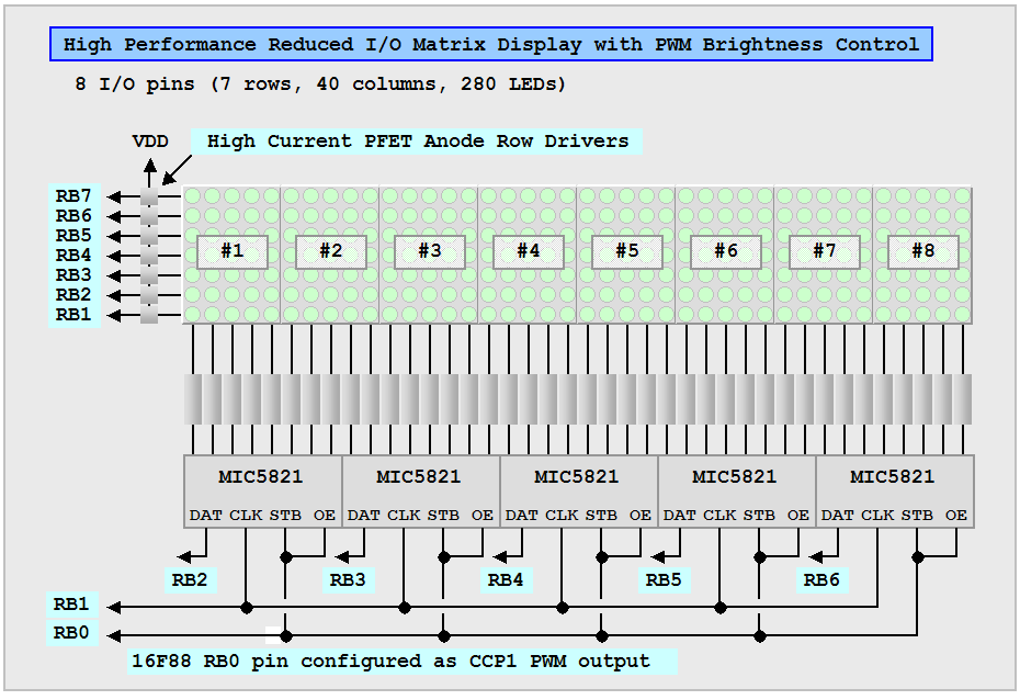

Just thought I'd mention that I've used an 8-pin interface version of this design in the past using a 16F88 with the RB0 pin configured as the CCP1 PWM output. I've included a drawing that shows how one might wire up 5x7 type LED modules.
There's also a TI serial-to-parallel sinking driver IC with 150-ma outputs which I suspect may work well in these designs. It's the TPIC6B595. I have samples but have not tried them yet.
Regards, Mike
