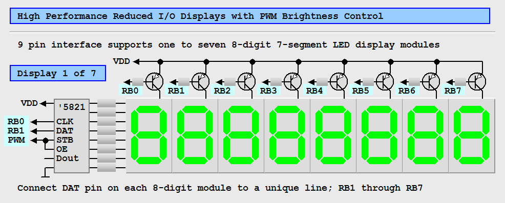

You should find the Data Sheet when looking up the part number on the DigiKey web site or perhaps the Micrel web site. The Micrel MIC5821 and MIC5841 are almost identical to the Allegro A6821 and A6841 devices.
I'm not aware of higher density serial-to-parallel high-current sinking drivers. If you find some, please let me know? Thanks.
Happy 2007... Mike
BTW, those hardware schemes grew out of designs for high performance reduced I/O designs for multiple 7-segment displays.
Have fun. Mike

The drawings were done using the built-in drawing tools in Microsoft Excel 2000. Here's another example;
I mean, with a regular PCB suit, you can export your schematic directly to your board, follow the wires and route.
With Excel, I don't think it is as simple?
Ok, it's what I was understanding. From my point of view, this solution is too time consuming and can leads to errors (their is no direct link between schematic and PCB), but, you probably have reasons to do so!
More positively: your schematics look better than any one made from a commercial package!
Thank you for the compliment. I suspect it is more work but I was hoping to make the drawings seem more visually interesting and intuitive.
Regards, Mike
