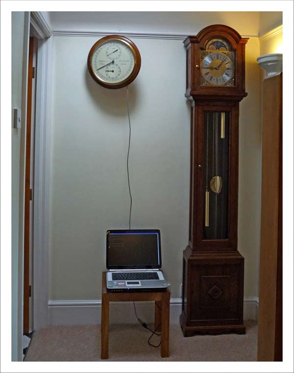

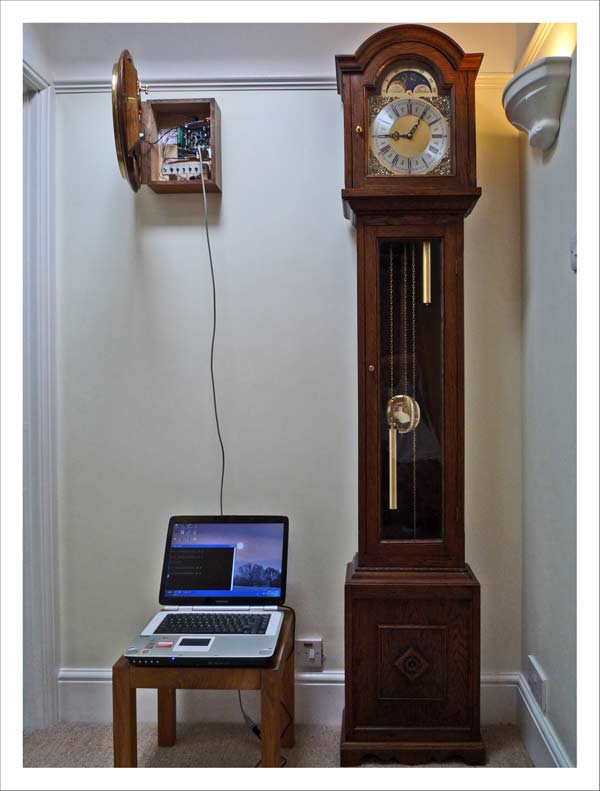

Thanks to couple of members of this forum I have been sent a PM with working code and diagram for a calendar clock. This was also converted for me to work with my 18f1320 PIC. All I had to do was write a tiny bit of code to add some extra pulses for my chosen movements.
I have built the calendar clock and tested it in situ and it seems to work fine. I now have to run the cables in to connect it to my master clock for final testing.
The day movement is a 120 cog wheel and needs 3 pulses per day while the month uses a 60 cog wheel so requires 5 pulses to move it a whole month.
The date is set on the calendar clock via a PC connected via a 9 pin RS232 connector. The pic can also be read via the PC and feeds back live date and pulse info over the same link. There are also some switches or man setting and reading the date from the PIC.
Below is a link to a demo of my calendar showing why I needed the extra pulses to step the day and month indicator hands at the end of a month. I have superimposed the com port display over the image so you can see the feedback as the calendar is pulsed. At the end you can see "months toggle" on the com port display. As there are 5 pulses to the months movement which is a modified quartz clock movement the month pulse has to start in reverse polarity to the previous month pulse.
A few more pics of my Calendar Clock in situe with my laptop plugged in setting the date to the pic. There is also a pic of the final version of the dial and hands filled shape.
Brett.
