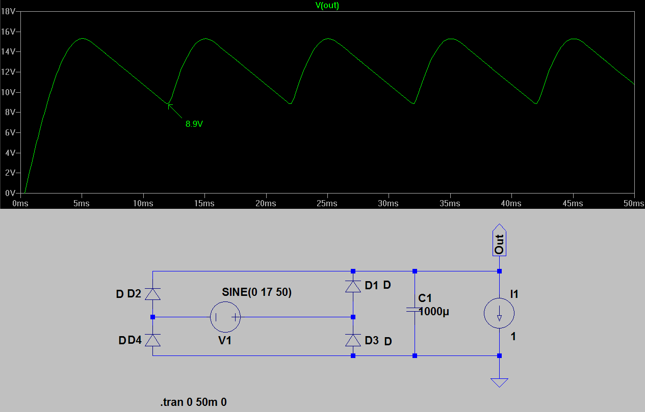

Sorry but that's total nonsense.
Let's simulate this example on LTSPICE.
A 12V transformer is modled as a 50Hz sinewave with peak voltage of 17V.
The linear regulator is modeled as a 1A constant current load, which is what it essentially is.
The ripple vally is 8.9V which is no good for an LM7808, let alone an LM7812.
Increasing the capacitor to 10,000:mu:F increases the ripple vally to 14.5V which is just about alright but I'd go even higher, I'd add another >3300:mu:F in parallel as the capacitor might only be 8000:mu:F. Always assume that the capacitor will be at the lower end of its tollerance when calculating ripple.
  • Rectifier.asc

Obviously a capacitor on its own will never completely eliminate ripple totally, it just needs limiting to an acceptable level and all I'm saying is that 1000:mu:F/1A won't always do this.

Well if you want to design cheap and nasty junk that doesn't work properly then fine, use your 1000:mu:F/A rule of thumb.
Normal designs only use the cap to keep the supply going when the instantaneous line voltage is below the RMS value or thereabouts.
Well in the example above 1000:mu:F/A didn't even do that, it droped down to 8.9V, way below the RMS value of 12V.
I'd rather keep the instantanious voltage above the absolute minimum voltage required for the design to operate properly. In the case of a linear regulator, this means keeping it above the dropout voltage plus the output voltage.

SPICE says otherwise, perhaps you should try it for yourself.
You also forgot the 1.4V drop for the bridge rectifier and made a mistake with your arithmetic, 17 - 15 = 2, not 3.
While you are correct in that I forgot about the diode drops, which BTW tend to be 1V or more at rated current, Bob Pease has often answered people not to rely heavily on simulations since they are often flawed by poor models.
I am only pointing this out, since you are fond of them, not implying that it is wrong in this particular case. If, for instance, you used a generic diode model you would definitely get the generic 0.6V drop instead of the more likely 1-1.2V of a fully loaded rectifier.
The generic model used in the simulation can't be that bad, on closer inspection of the graph it has a voltage drop of 1.7V (0.85V per diode) at the current drawn.
I agree SPICE isn't perfect, there are also other things that the simulation probably missed, like the ESR of the capacitor and that the transormer will have a much higher voltage than 17V off-load and will drop down when loaded. These things can be added to the model but there are other things like: dielectric absorbtion and changes occuring as the temperature of the components rises (due to self-heating) are harder if not impossible to simulate.
