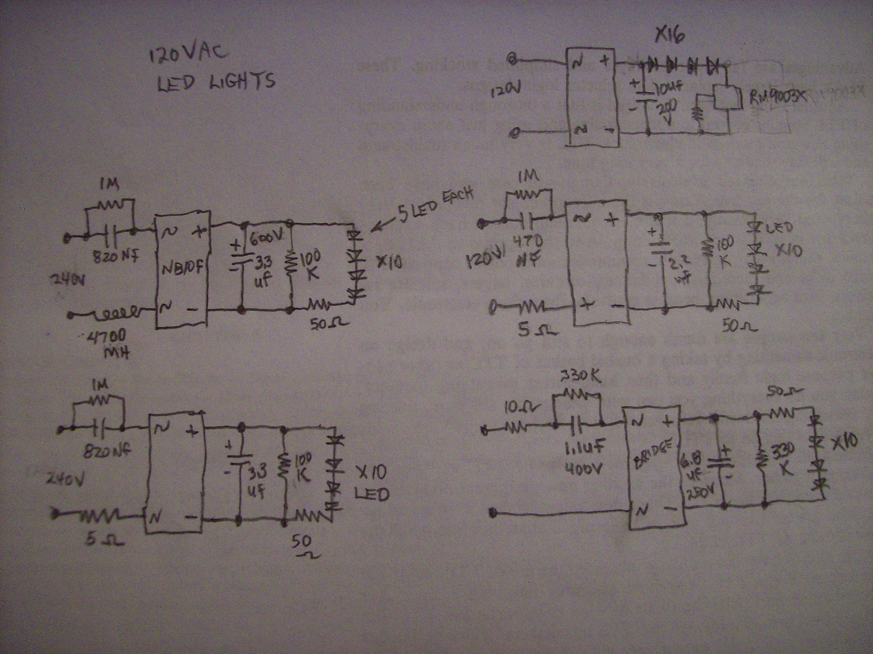

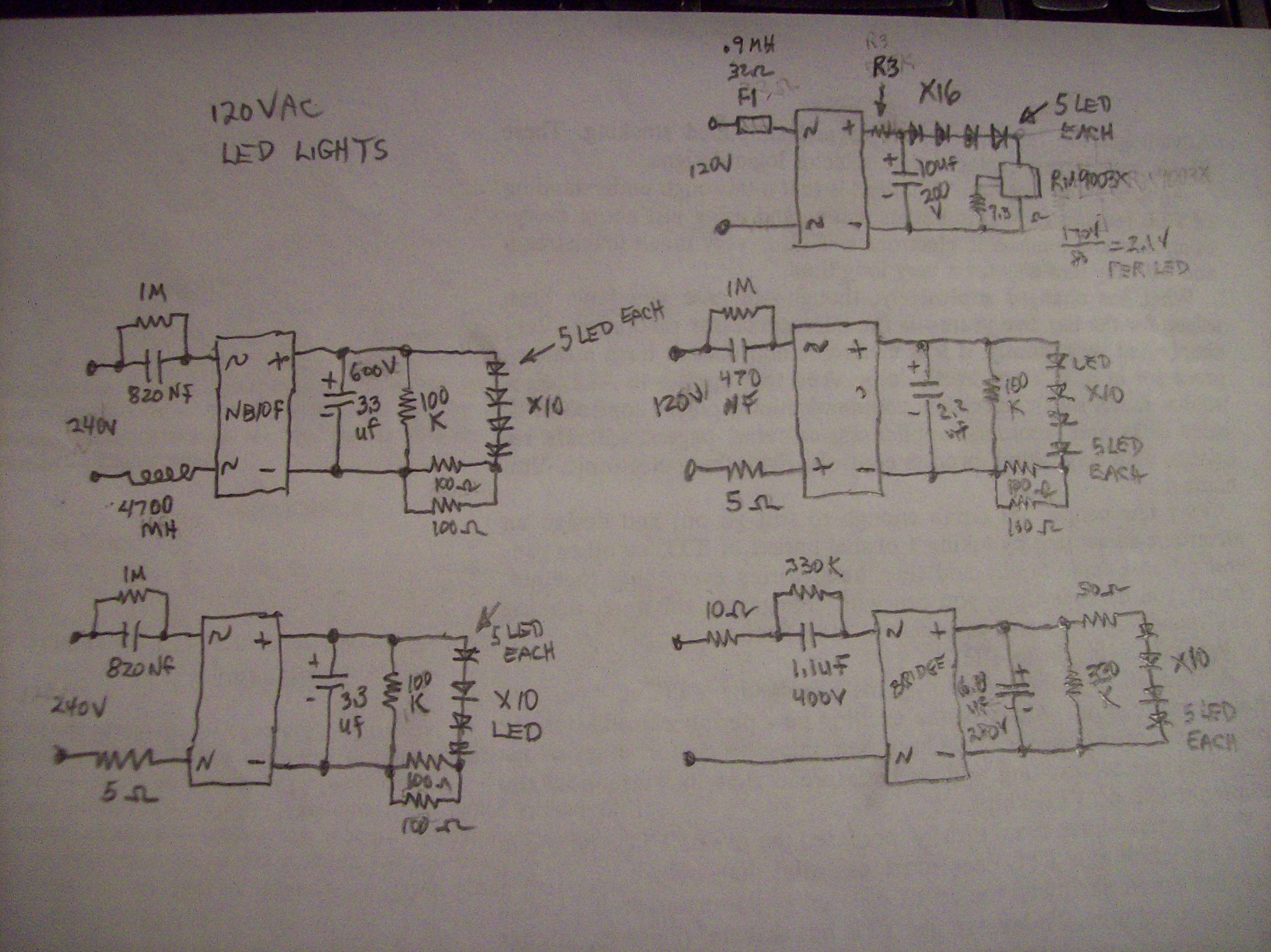

If anybody is interested, when powered by ~120VAC, the voltage across each LED is 8.9 volts (DC) and the current through the LEDs is 57mA. Each LED chip must have 3 LED elements in series for the voltage across it to be almost 9 volts.
Voltage across the string of 16 LEDs would be about 142 volts. The DC voltage provided by the rectified AC voltage is approximately 1.414 × 120 = 170 minus 2 × 0.7 for the two diode drops of the bridge rectifier.
The claimed power of the bulb is 8 watts - the measured power draw is 8.9V× 0.057A × 16 LED chips = 8.12 watts. That's pretty good agreement between the specification and reality.
If I get really ambitious, I'll plot current drain vs temperature as the board heats up. The RM9003A should decrease the current as the temperature increases.

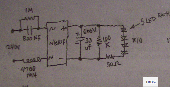

I do not see a reason for the 50 ohm resistor. Current limit is done by the 820nF capacitor.
The 3.3nF 600V cap could be a low voltage cap. It only sees the LED voltage. I have built this with one LED and used a 6.3V cap. In my example of one LED I also used 50V diodes.
I like the idea of a small inductor but just used 5 to 50 ohm of resistor.
In all the examples of this circuit the LED voltage is much lower than the power line. (5x10=50 leds) I have never seen that many LEDs. If the LED voltage approaches the line voltage then the 820 cap does not do its job to limit the current.

The 50 Ohm resistor is used to keep the current more constant. Without it, the capacitor will only raise to the forward voltage of the LEDs, so the capacitor voltage can't change much, so the energy it is storing can't change much.
With a resistor, the peak capacitor voltage will be larger than the breakdown voltage of the LEDs, and during the period when there is no power coming from the rectifier, the capacitor will discharge and its voltage will fall towards the breakdown voltage. There is now a change in voltage, so the energy in the capacitor is changing, and it is smoothing out the flow to the LEDs.

The 50 ohm resistor is really two 100 ohm resistors in parallel, probably to double the watt rating.
