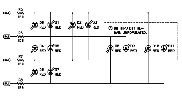

on pages 31 and 32 of https://www.electro-tech-online.com/custompdfs/2007/01/40051D-1.pdf look at the three LEDs D7, D5, and D1.
Is there any possible way to have them 3 on at the same time?
In reality NO, but practically 'yes', you turn them on in turn at a fast rate, and they give the appearance of all been ON. It's called multiplexing.

setting all pins as output, then pin 2 as HI, and pin 6 LO. The LEDs are in series, so why wouldn't they all light up? is it due to the pins inbetween each LED, if so, what sort of impact are they having being set HI or LO.
If you looks closely, the LEDs are connected back-to-back.
When connected in this way, current in one direction will only go through one LED and the remaining LED will not light. Don't forget LED are diode too.
IF they are ordinary bulbs, then this connection method would not work.
Hmmmm, the LEDs D7, D5, and D1 are in series, not back-to-back, so i would expect them all to light up.
I'm aware of LEDs and how they only work one way round, but from the diagram in that document, they are all in the same direction.
So that's all that's stopping them all from lighting? the I/O of the pins in between don't affect? (apart from the obvious)
it's just that the current can't get that far?
I'm surprised an LED eats up so much current???

It's NOT the current, an LED takes a certain voltage to light - roughly 2V or so, so three in series would need 6V in order to light at all.
The current flowing through more direct path of one led, which drops only 1.8V, would prevent other series LEDs in parallel from turn ON as they need a higher total voltage to do so. If this is the answer you want to know.
SO D11 lights and in doing so, prevent D1, D5 and D7 lights.

LEDs D7, D5, D1 are not in series across RA1 -> RA4?
Am I missing something? (obviously you beat me in the edit! :) )

Perhaps I've had too many beers, but here's the situation...
RA4 ---+
LED (D1)
RA5 ---+
LED (D5)
RA2 ---+
LED (D7)
RA1 ---+
Setting RA1 to HI, and RA2, 5, and 4 to LO, should, in theory, pass current through all the LEDs?
I see what you're saying about setting pins to Input to 'disable' them, but if i wanted them all to light, is it simply the consumption of each LED stopping the next to light?
I think we've already decided this, but would like to be sure.
Also, why the big pull away from 'current'? surely they're eating up the current rather than the voltage? true, it's been a while since I did electronics like this, bit of a refresher course would be nice.
Thanks for all the info and help, I thought it was cos of the current/voltage that was stopping further LEDs from lighting, just been looking for the clarification.
Very much appreciated... I'll have a space-rocket built in days at this rate! :)

No, I've already explained the LED's aren't in series at all, UNLESS RA2 and RA5 are set as inputs (and still wouldn't light anyway). Your connection above connects D7 across the supply, and the other LED's nowhere.
LED's aren't resistors, ohms law doesn't apply - I've already explained that you can't light three LED's in series across a 5V supply, it's too low a voltage. If you place two LED's in series then they will both blow, as you need a current limiting resistor to stop them taking enough current to destroy themselves - the PIC circuit above crudely relies on the current capability of the PIC to limit it.
