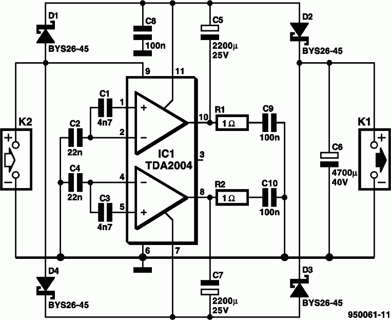

Here is a Unique one using car amp.

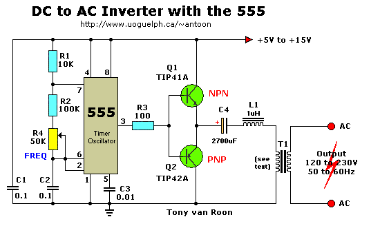

Ommit the transformer on this one.
mini DC to AC converter
Thanks for the suggestions. I will try both of these circuits and let you know how I get on. From first glance it looks lie each could give about 24V AC, which isn't too critical. 20V - 28V would most likely work fine. The frequency wouldn't need to be exactly 50Hz either.
