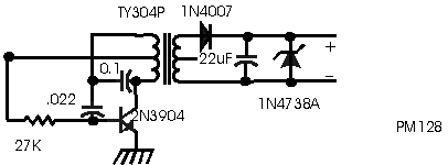

I have used 600 ohm to 600 ohm telephone line transformers on a number of occasions to build isolated inverters. The junction of the 27k resistor and the CT is the + supply.
The attached circuit uses a 2N3904 transistor in a simple oscillator.
Hope this helps.

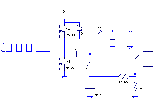

Have you thought of something as simple as this?
Diode D1 is to protect M2 from transient current through C1 when the battery is connected. The substrate diode might be sturdy enough to handle it.
M1 and M2 could be some sort of monolithic driver. Or, they could be bipolars.

I kinda like this one. Is it really kosher to use a telephone transformer like this? This might go into a marketable product- is there anything funky here I should worry about?
