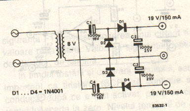

ok, i got this circuit(sorry for the bad scanning). and i was wondering if it will work(with out the transformer) with a square wave genetared with a 555...?

the IC looks ok, but the current it supports is too small. i think that ill try to convert it to a.c. and then use the circuit above
