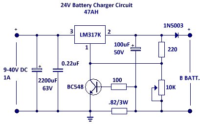

question: can anyone help with a schematic of how to build a 24v charger for two 12v 700cca marine group 31 batteries to charge from a car 12v source and not overcharge the batteries
-this schematic is the only one i could find-

hi and welcome,
That circuit is not suitable for your application.
The 9V to 40V input and 24V charger is misleading.
It should say IMO, 24V input for a 12V battery charge output, also the LM317K will get very hot.
For any voltage input less than approx 15V it will give less than 12Vout.
You require a 12Vdc to 24Vdc Boost converter circuit.
