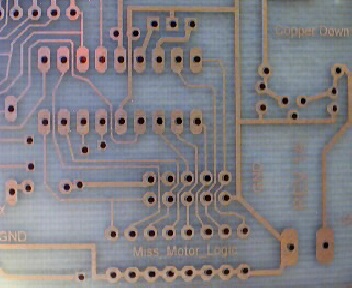

The toner goes between the paper and the copper. I run the board through twice flipping it after the first run. It seems to help keep the thin paper cut boards from warping. There is enough heat (at least on my good laminator) that it works both ways.
Success with .014" SS stock.
Looks like it works, at least with the thin stock. Ran this board through 4 times moving it from side to side. There is some danger of the toner spreading if you run it too many times but it looks OK. I laminated the Pulsar green foil to the toner to see if the foil would lift any toner, it did not.
It is a credit card sized SS board on the .014 inch stock. It is medium dense Eagle board with many .01 inch traces, 35% restring, and 15mil spacing. I never like taking pictures of copper but here it is. The image is sharper the it looks here. The small text is quite clear. See attachment.
I also tried a board on the DS .022 in stock. It did not work but it may have because I did a poor job of cleaning the badly oxidized board. Or it could be that there just was not enough heat. I will try again tomorrow.
On the up side I like this machine feeds/handles small boards. With my larger units I have to coax them into the machine with chop sticks.
On the down side it makes a clicking noise every now and then. Not sure what that is about or if it is a problem. Could be a thermostat? I am not sure if it can generate enough heat to heat the thicker board. The board moves quite slow and much of the heat is lost between passes.
More when I know it.

Nice board but it reall isn't a good idea to route traces inbetween DIL pins as it can create problems when soldering and you might have a very fine track between them that you can't see.
Don't SMD parts like processors heave even tighter spacing ?
I last made PC boards in the 80's. When I started again a year ago I had some problems with hidden shorts. Since then I switched to SP etchant, a temp controlled solder station, liquid flux, and .015 solder. I do not know if any or all of these contribute. But it is working well. The Pulsar paper could be part of what make it work.
Correction: In my last post I said spacing was 15 mils but it is actualy 10 in the tight spots. Most everything else but the connectors is at least 20 mils.
