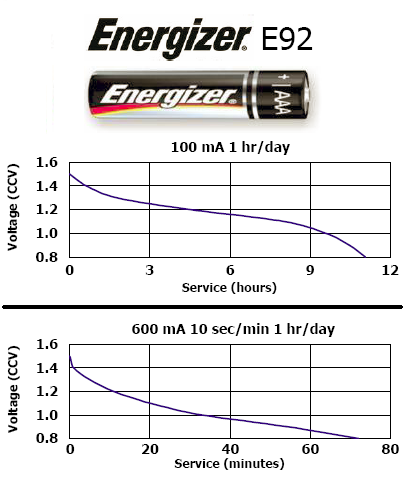

Hi HarveyH42,
recently i purchased a 8 LED table light (mini and cute) works with 3 AAA ordinary cells. Lighting was really good. i was thinking the cells might work for 15 mts or so. one night i switched on and left. next morning it was still glowing --ofcourse celss have come down from1.5 to 1.2. wondered, i opened and saw thereis nothing--noelectronics. straight parallel lamps with switch and batteryof 3*aaa
the current measured at 3.6V was around 100mA. the cells were just ordinary chinese make-- i mean not DURAcell. i only wonder how you cold estimate 200 to 700 mA ?
I don't know about el-cheapo Chinese battery cells, but Energizer has datasheets for theirs. The little AAA alkaline cell is too small for much current for much time. You can nearly see the LEDs dimming with a 100mA load.
