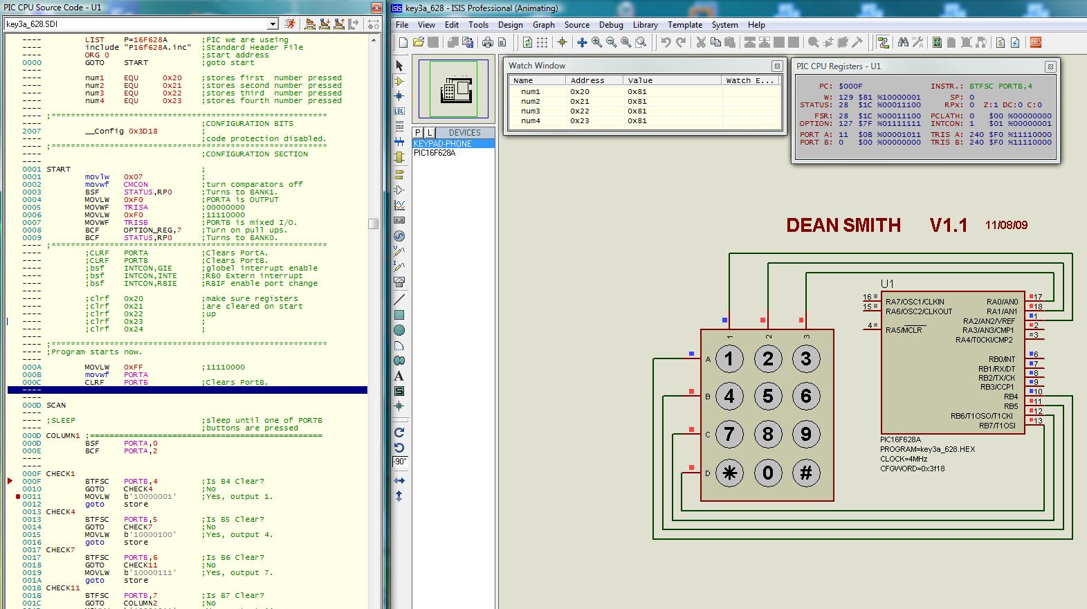

Hello, can someone please help me to get my code working properly. It scans a 3x4 keypad, when a key is pressed the value is stored in a register. 4 keys are to be stored this way. The first key value is stored ok. When the program scans the second key, it stops on the last key that was pressed. It appears that the internal pull up resistor is latched low therefore holding the first key press and jumping to the second store register,storing the value of the first key press.
Problem 2. I want the PIC to go in to sleep mode and start scanning when a key is pressed. I got it to work but when i pressed a key the program started scanning but didnt find the first key to be pressed. ie i would have to press a key twice to get 1 number, once to wake up from sleep and once to scan a key. How can i do this so that the wakes up and with the same key press stores the value.
I have the rows on portB <4-7> because of interrupt on change to wake up from SLEEP. Columns on portA because i want to use RB0 interrupt and RB2 TX , If i ever get that far. :( . I guess thats all a bit confusing, please see attached code and jpg. Thanks in advace.

You should use an ISR when it wakes up from sleep, at org 0x004 tell it to "goto ISR" or something like that!
I think you need to clear the bit which says an interrupt occured (I might be wrong ).
birdman is right. You need to add an interrupt or timer to wake up the pic from sleep. Also at the moment your pic won't sleep.

first of all thank you for your replies. I realise that the sleep routine code is incomplete. I deleted some lines and cancelled out some of the code with the semicolon(;)because i was trying to solve the other ploblem(scanning the keypad and storing results). Also I did read somewhere that if the GIE bit is set and the RBIF bit, then the ISR jumps to to 0x04, BUT if only the RBIF bit is set then the next instruction to be executed is the one after SLEEP. hav'nt go around to trying it though, can anybody varify this ?? I was kind of hoping that some wizkid would fix my program and post it back to me. There are probably a 1001 ways to scan a keypad and store data. Id be grateful for any comments, thoughts and ideas. :)
The pic will wake up if an enabled (RBIE=1) interrupt bit is (or becomes) set - if GIE is also set then an interrupt will occur. Make sure you clear RBIF before sleeping.
One thing on your keypad read, you are setting one column at a time low and the others high. This can cause a problem if two keys are pressed simultaneously. Say keys 1 and 2 are both pressed and you are scanning column 1, you now have a low on RA2 and a high on RA1 connected together. The way to fix this is to set the scanned column to output (and low) and the other two to input.
I have not looked at your code, is it now working?
Thanks Mike, I will try the sleep routine, but first I need sort out why I cant save the value of the key strokes in the registers(num1,2,3 and 4).
As for pressing two keys at once, well I think i understand what your saying, but cant see how that would cause a problem. for instance if i pressed numbers 1 and 2, wouldnt it scan the first number that made a contact and jump to the next instruction after BTFSS, sorry if im missing the point here. I will bear it in mind and try it your way after i have sorted out the issue on saving the numbers in the num registers. :confused: Its me who needs a sleep routine its driving me up the wall.

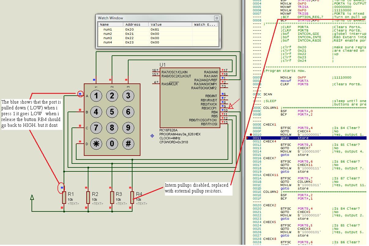

Hi Mike, Ill try and explain the problem another way. If you look at the attached thumbnail(key3.jpg) you can see the watch window. The result 0x20 num1 is 0x81. so far it done as it should have.
SCAN
column1
check1
BTFSC PORTB,4 ; number 1 has been pressed intern pullup is LOW, so skip next instuction
goto check4
MOVLW b'1000 0001 ; = 0x81
goto store
... ;so far so good
store
BTFSS 0x20,7 ; contents of work register to be stored at 0x20 IF it is 0x00
GOTO numbers1 .... ok nothing stored here, go to numbers1
BTFSS 0x21,7
GOTO numbers2
BTFSS 0x22,7
GOTO numbers3
BTFSS 0x23,7
GOTO numbers4
goto SCAN
numbers1
movwf num1 ;contents of work register is 1000 0001 ( now in num1)
goto SCAN ; now go and scan for a second keypress.
this is where the problem starts. The internal pullup on RB4 is latched low
so without pressing a key, number one is found again and the value is put in to num2.
the cycle starts again, intern pullup is still low, now the value is put in to num3 and again to num4. what i need to do is reset the intern pullups. after a keypress it stays LOW.
It needs to be HIGH to be able to scan the other keys.

Ive tried using resistors, same problem. I will try with a debounce. I didnt want to build a curcuit that doesnt work, although it did cross my mind that it could be a simulation problem. Ill make a hardware version and let you know how i get on. Thanks for you help its really appriciated.
the free versions have restrictions, limited pin connections and a few other drawbacks. Two choices, proteus LITE and the full demo version. ill send you some links so you can see what it can do ...
