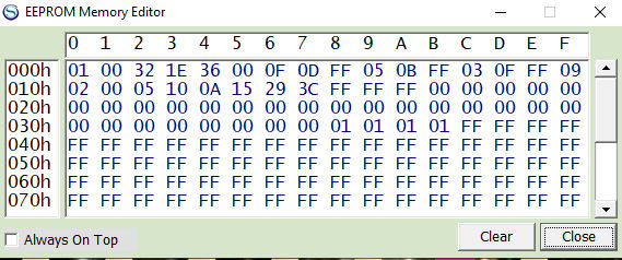

Terry,
I note that EEProg resets the bank to zero before returning. And is called assuming bank 1 is selected. Note also the increments of EEADR.
I.E.
InitISD
        movlw   d'1'            ;0.1 sec message length default
        movwf   EEDATA          ;put into EEPROM data register
        movlw   EEM0LEN         ;address of message 0 length
        movwf   EEADR           ;set EEPROM address to program
        call    EEProg          ;program byte
        incf    EEADR,f         ;increment address of byte to init
        call    EEProg          ;program byte EEM1LEN
        call    EEProg          ;program byte EEM2LEN
        call    EEProg          ;program byte EEM3LEN
It may be safer to not switch back to bank 0 in EEProg and to move all Variables into common area (0x70-0x7f).
There seems to be lots of places that EEADR is modified throughout the code.
I.E.
PNorm
        movf    msgNum,w        ;get message number
        andlw   b'00000011'     ;mask out bits 2-7
        addlw   EEM0LEN         ;add the base of the message lengths
        movwf   EEADR           ;save address
        call    ReadEE          ;read EEPROM, w will have message length after
        movwf   isdTmr          ;preset message timer
        btfsc   STATUS,Z        ;is the length 0
        return                  ;yes, don't play.
        bsf     PORTB,ptt       ;turn transmitter on
And here,
RecEnd
        andlw   b'00000011'     ;mask out bit 2-7
        addlw   EEM0LEN         ;add address of message 0 length
        decf    isdRTmr,w       ;get timer - 1 (less 100 ms)
        movwf   EEDATA          ;put into EEPROM data register...
        call    EEProg          ;save message length
BTW, well done on doing this, I'm sure the OP is very pleased.
Edit, and EEDATA.
Thanks Mike, I'm doing this in between other things so having other pairs of eyes is most welcome.
I did think about moving various registers to the common area but decided there was too much chance of fouling things up even more, although it may come to it.
Jaison, OK, it will get there eventually. Just a few odd things to make sure are correct as Mike has picked up above.
As there's 16 SFRs used (0x20 to 0x2f) then they'll all fit in the common area which will make it more like the 84 as all SFRs were common. They could be accessing SFRs from bank 1 as it would have worked fine on an 84.
Actually, just counted and there are more than 16 - comment is wrong.
However, w_copy and s_copy definitely need to be in the common area.

Completely superfluous.
Edit, the datasheet does indeed recommend this but if you check AN576 it only applies to 16Cxxx, so not applicable.
I figured it might be a good idea to track down any other info on the repeater controller to see if we were missing anything.
Lets just say maybe we might be - the code we are updating is loaded with default values which might be different to what is loaded in Jaisons 16C84 - I don't recall ever using a 16C84, so correct me if I'm wrong - you can't read back the contents of the 16C series like you can with the F series? If you could retrieve the EEprom contents, they could be compared to the defaults and even updated in the file.
Default values:
The user guide attached is for the version D unit, but the details appear to be the same as the original article apart from using a 16F84.
