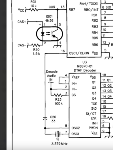

Does anyone know if a 628 can use an oscillator like this?
Yes with the EXT_OSC function in Config, I've done that before.
It's much the same as running a TCXO or other oscillator module in to it - one of my current 16F628A based Frequency counters is run that way with an external oscillator reference.
