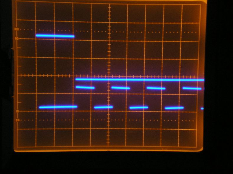

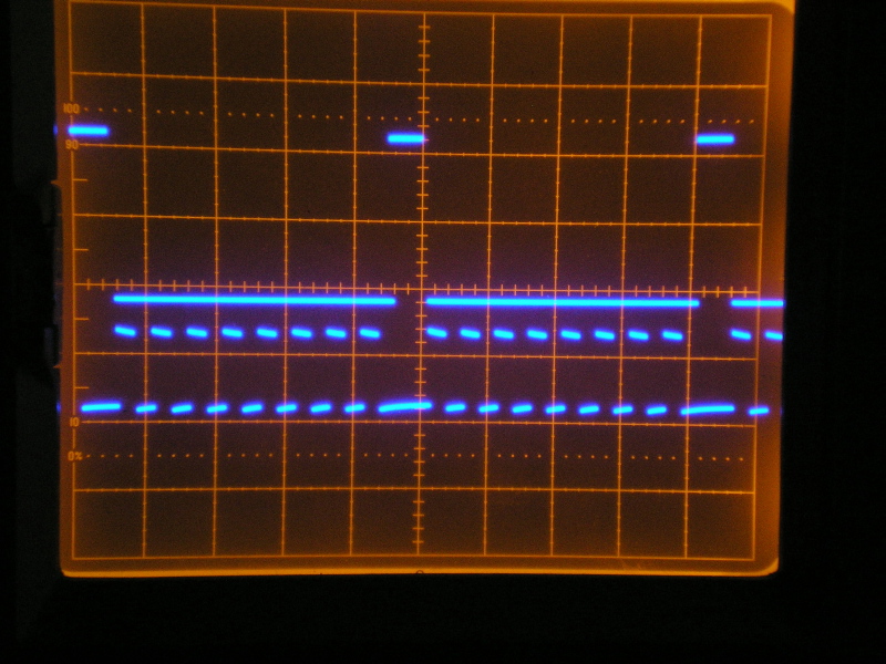

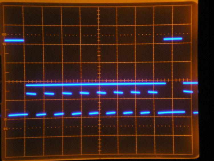

Edit: What is the timing relationship of the high going pulse to the clock signal? Is it one bit long? Part of a bit? A picture would sure help.
I haven't tried reading the TRMIT bit before loading the TXREG yet - I'll do that later today.
The timing is not apparent because I am restricted to a single trace CRO, but I may be able to borrow a more suitable type.
The bit width is the full 104uS (9600bd) as far as I can tell.
kenmac
OK, I have the answer.
I went to the trouble of borrowing a dual trace CRO to examine the timing of everything.
It seems that in between bytes the output pin is returned to the high state "1".
For continuous data, this state holds for the time of one bit.
This will not be read at the receive end, because the clock pulses are only generated one per data bit, i.e. 8 pulses per byte.
I had assumed that the clocks were continuous while Tx was enabled - not so.
I took sime pics of the CRO screen, and these are attached.
kenmac
