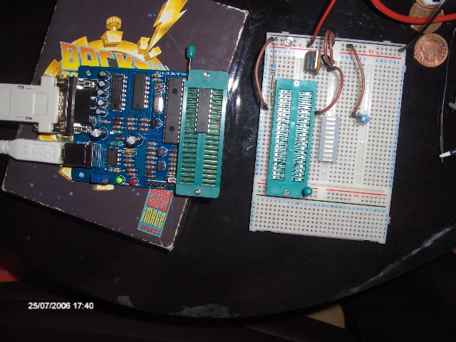

HI,
Please can someone help me breathe some life in my PIC 16F628A.
I have been reading about them for a short time now. I have understood (I think) things like TRISA TRIAB PORTA PORTB., DECFSZ, MOVLW, binary no. hex no. etc.
Today I actually received my 16F628A and a programmer that claims to be MPLAB compatible (works as PicStart Plus)
I have been fighting with it all day trying to get just a peep out of it – I was really struggling with it in MPLAB. It seems to fail often when writing to it. Refused to erase.
After a few hours of disappointment I found the problem – I had selected 16F628 and not 16F628**A**!!! It seems to work in MPLAB fine now.
But I still cound not get a peep out of it in my circuit.
Im tired from fighting with it. Please can someone spoon feed me and give me the header etc. how to select the internal oscillator/ what I need on my external circuit. Set all PORTB to outputs as I want to flash some LED’s on PORTB. Any little things I need to do in MPLAB (watchdog setting etc.)
I have been using the following as a guide
(PIC 16F628, scroll down)
I could not find 4.7k ohm resistor so I used a 6k one – does that matter?
Also I bought a ZIF for my bread board – are the pins long enough to make proper contact? They seems a bit short and I could not read a voltage between pins 5 and 14. Turn it the other way round started to work. Will sanding down the little round feet help?
Could someone modify the following for a 16F628A and get pins RB4 to RB7 to flash or give out logic1. so I know all is working then I can take it from there -

Hi there,
Try checking the 'Low Voltage Program' in the config. If its 'Enabled' Disable it.
I have had this problem before where the PIC just sits there doing nothing.
Hope this helps
Regards
Pete
change your return to RETLW 0
The LVP mode is already disabled but try to change your CONFIG line to this one
__CONFIG _CP_OFF & _WDT_OFF & _PWRTE_ON & _BODEN_OFF &_INTRC_OSC_NOCLKOUT & _MCLRE_OFF & _LVP_OFF
i tested your code with the above suggestion and it works.

OH MY GOD!!!!!!!!! - it works!
I could not believe it so I went back and changed it to the original (_MCLRE_ON) it stopped working. Changed back again and it worked. - You have saved me a lot of time and heart ache.
If anyone would like to explain the -MCLRE_ON/OFF that would be useful.
Thanks once again mister_e
Mike said:
MCLR_ON requires the pull-up resistor. Perhaps you didn't install that 6K0 pull-up?
Mike
You hit the nail on the head – I plugged the other end of my 6k resistor in the –ve line not positive, damn those bread board holes are so close!
I changed the code back to the original and it works with that one too now.
Thanks Mike.
