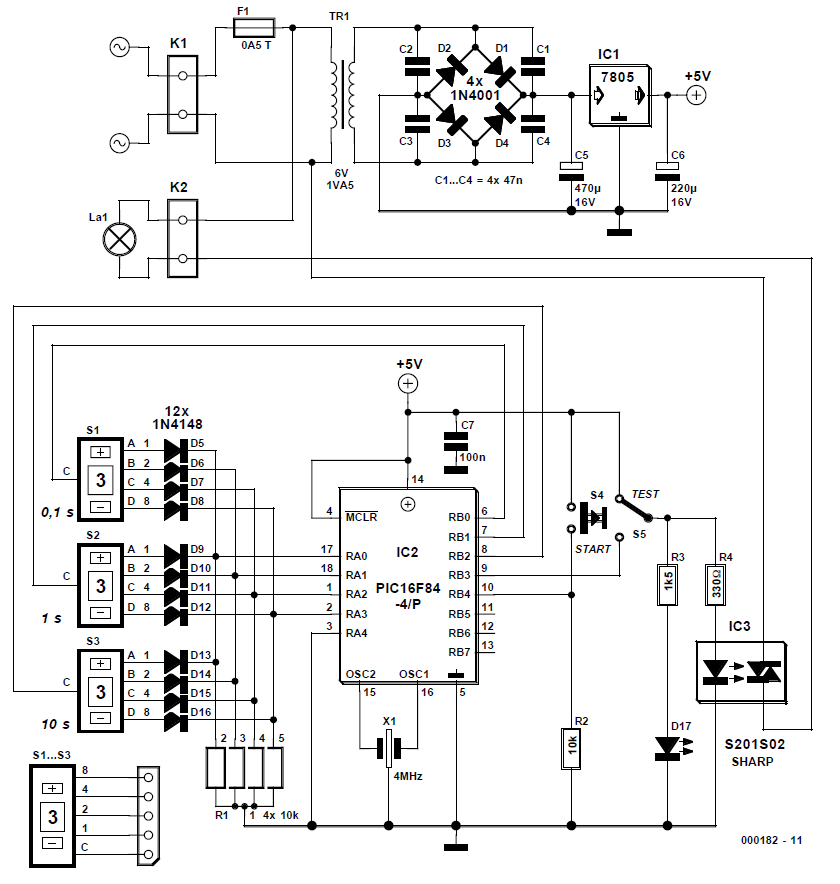

My Problem is, that i've builded up a 16F84 based darkroom timer and can't programm the PIC.
The schematic was published in 2001 by Elektor.

Tell me which pins on the 16F84 are inputs and outputs.
I've uploaded the schematic and the provided files on a single .zip file.
There you can see which pin is in- or output.
Thank you all for your help.

here is the schematic. Perhaps, you can simplify the whole thing i hope.

The whole circuit is imho not bad.
I will not use it as a darkroom timer but as a precision timer for inflating balloons for my wife. :)
She is into this business.
So the issue for the BCD switches in low light conditions does not apply to my actual needs.
@mvs sarma,
would it be to much to ask you for a version of the code for use with the internal osc? :eek:
PLEEEEAAAASE ???!!!??!! :)

What time delay ranges do you want for inflating balloons.?
The range depends not only on the time but also on the provided pressure.
If you have a timer with 0,1 sec accuracy you are ok.
You can then also adjust the input pressure and the end result is perfect.
The timing must be adjustable to inflate different balloon sizes.
The size of the balloons ranges usually from 5" to 3 feet in diameter.
With this timer we want to inflate balloons from 5" to 12" diameter.
For this balloon sizes i aim a inflating time range from 2 sec to 5 sec , and with a input pressure below 80 psi (5,5 Bar).under
The output pin of the PIC will control a 230VAC valve through a Sharp S201S02.
I forgot to mention that i will stay under 10 sec.
