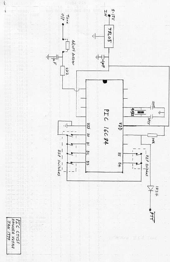

First of all, I know it is a well documented subject, but I have now spent many hours trying to find out what changes I need to make to my 16F84A code, to make it compatible with a newer 16F628A, and am now a little confused by all the different sources of information, I have searched for the migration document that Nigel mentions in a lot of his posts with no luck, I am very new to PIC programming, and not confident in what changes need to be made,
I would also like to enable the internal oscillator to save on external components, and to add higher accuracy than when using a external resonator. I have the assember code, and understand that I need to add a couple of extra lines of text.
I can upload the text file if this helps, the circuit is for a very simple CTCSS tone generator.
Many thanks in advance, Karl.
The only changes I can think of are to the configuration line for the internal oscillator, and add the lines 'movlw 7', 'movwf CMCON' to disable the comparators to allow use of the digital pins.
The other main change is the user memory (SFRs) starts at 0x20 instead of 0x0c. There are also differences in the peripherals but these are not really a problem unless the code uses the EEPROM.
I suspect MicroChip removed the migration document when they re-released the 16F84 at a vastly inflated price - I wish I'd saved a copy back when it was available :D
As suggested, there's very little to alter, add the two comparator disabling lines, alter the config word, and alter the GPR start address - if you use the data EEPROM, I seem to remember there's a slight difference there as well.
Thankyou Pommie, will try it in a circuit tonight and let you know if it works OK, forgot to ask, is this code using the internal oscilator or external?
Karl.
It is using an external 4MHz crystal. You could change it to use the internal oscillator but it is only accurate to 1% and this will cause problems with the frequencies.
Still no luck with the code, I assembled with the MPLAB software and programmed a chip but appears dead, am going to study the differences in the code and try and make sense of it, I hate to be beaten!!
I have attached the files, from what I have read online and thru the posts, with changes made it should work.
Thanks again for your help.

On a very quick look, you're not turning the comparators off still, they are in bank 0 not bank 1.
You're also not declaring the processor.
I've done those very simple mods, try it now.
  • 16F628A.ASM
Thanks to everyone for the help, all now appears to be working perfect, Karl

The only fault I have noticed is this:
bsf STATUS,RP0 ;SELECT REG BANK 1
movlw 0x07 ;turn off comparators
movwf CMCON
bcf STATUS,RP0 ;SELECT REG BANK 0
I had trouble with the above and placed:
movwf CMCON
in bank 0. This fixed the fault.
