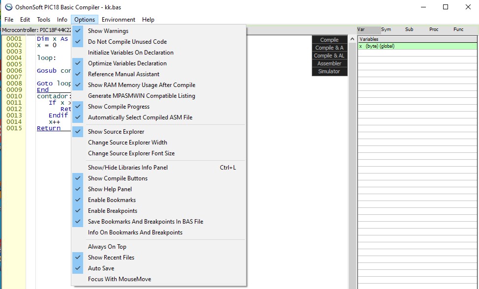

This IDE option allows you to include "Includes" with many different functions, but only those that are actually used are compiled.
